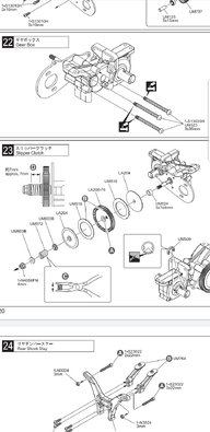

Sounds fun! I finally opened the box today lol. Should be a good challenge. They are calling out generic grease in the additional materials needed portion. I have lithium, red n tacky, marine and some other type I can't find rind right now. We moved this past weekend out of state and my life is in boxes. Would any of those work for the assembly? Except the mystery lube of course haha
You don't need extra grease. The kit comes with grease, clear and black. The black one has graphite in it. On each build, where grease is needed, it will tell you which one to use. I would recommend getting some locktite. Purple or blue will work. I prefer the purple because of how small the screws are. It doesn't hold as tight as the blue.
Damn it if it didn't come up on the first step. Any idea which one I should use here?
