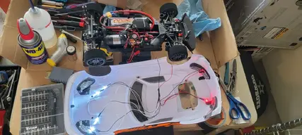

Got the light kit.

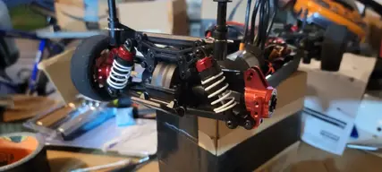

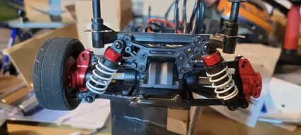

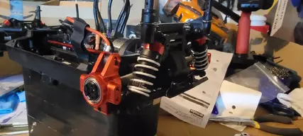

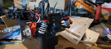

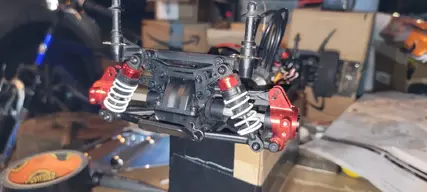

I just installed the metal Rear Hubs. They look sweet! I have the metal Front Hubs arriving in couple days. Also, I'm replacing that silly silver plastic rotor/hub with the FAW204 HD Wheel Hub that screws onto the bearing hub. I already removed the red plastic caliper. Unnecessary. For those that want it to look cool, I understand. I prefer functionality over looking cool. Plus you really can't see anything when its going over 60mph.
I have to order a couple more clear bodies because I've already bashed and cracked the Mercedes body. :thumbs-down:
BTW, I've ordered the Carbon Fiber shock towers and Carbon Fiber front bumper mount support.:thumbs-up:
