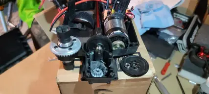

Rebuilt front differential. Tomorrow the rear. Don't forget to make a gasket! 30k wt. in the front. I'll put 60k wt. in the rear and see how it acts.

I was messing around with the rear differential and decided to replace the pinion. I put a 35t and adjusted the motor mount. No time for the differential tonight. Maybe tomorrow. Its been raining here in Texas, so I can't test it anyway. 🌧️ I got a metal spur gear but its not for my car. Its for a different Kyosho.

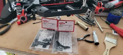

Got my carbon fiber front bumper support in and installed. Looks good and gives it tons of strength on the front end.
I ordered the FAW204 Red Metal Hubs but they DO NOT FIT this car unless you have a +10mm offset wheel. The FAW204 red hubs have a 0mm offset and can't use the stock wheels. I screwed the wheel bolts with these red hubs and wheels do not spin or turn because the wheel screw drives into the dog bone. The FAZER and FW06 use the same wheel and offset which is +5mm from the hub. So the Red Hubs don't work.

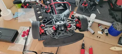

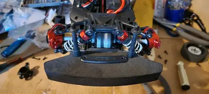

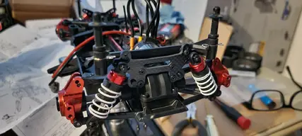

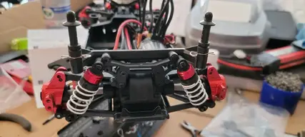

Got my Carbon Fiber Front/Rear Shock towers delivered and installed. I think I got 2 or 3 more upgrades to do them I'm done for a while. On payday I'll order the aluminum shocks (FAW225 TC Aluminum Shock Set) and metal dogbones (FAW202 TC Universal Swing Shaft S). Then I'll do some high speed runs.

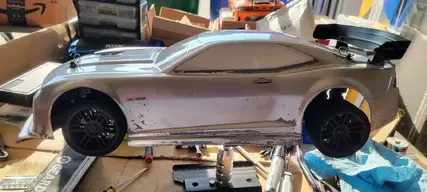

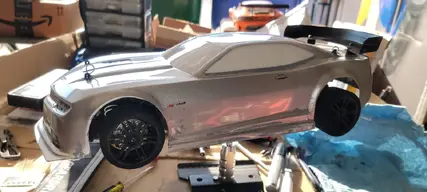

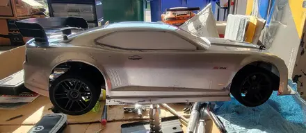

Finished painting the Camaro body and applied the stickers. The original paintjob had a glitter undercoat (non-polycarbonate paint) and it flaked off with the air and vibrations so, I had to start over. I was able to scrap off about 99% of the old paint and apply the Silver with black underneath (Tamiya Polycarbonate paint). Can you say, "BASHER BODY!"
