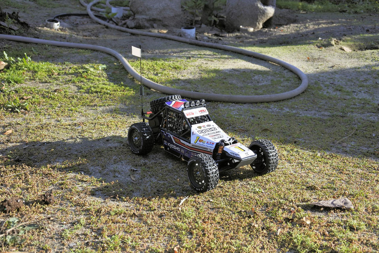

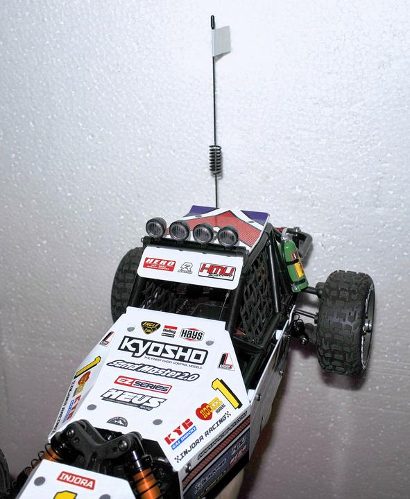

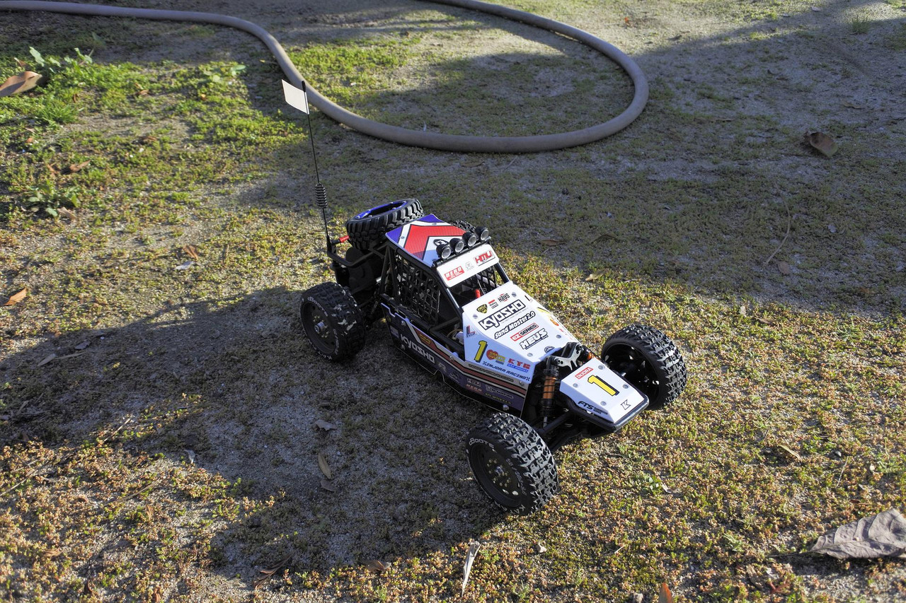

The new tires for the front went on last night. I expect steering will be good still. Didn't give me any clearance issues so the st/r is still set the same. I have been setting this up to be a car for mostly real dirt and sandy type conditions. Currently I don't think we have had a single day that has been over freezing in a month, so ideal testing has been rough.Thank you for the drop video, it really plants itself! I read that the Team Associated gray's have a spring rate of 2.55 lb/in.
Does it steer pretty well with the new front tires? I saw someone else go the opposite direction with more narrow front tires so I was curious.
That's what I said.
I had a full selection at the hobby shop. These were chosen on purpose, not because they were the only option available.Ultima springs are shorter, same diameter if the spring length becomes a problem.![]()
The black roll cages are discontinued , and still available on ebay![]()
I can only take so much greatness at a time.

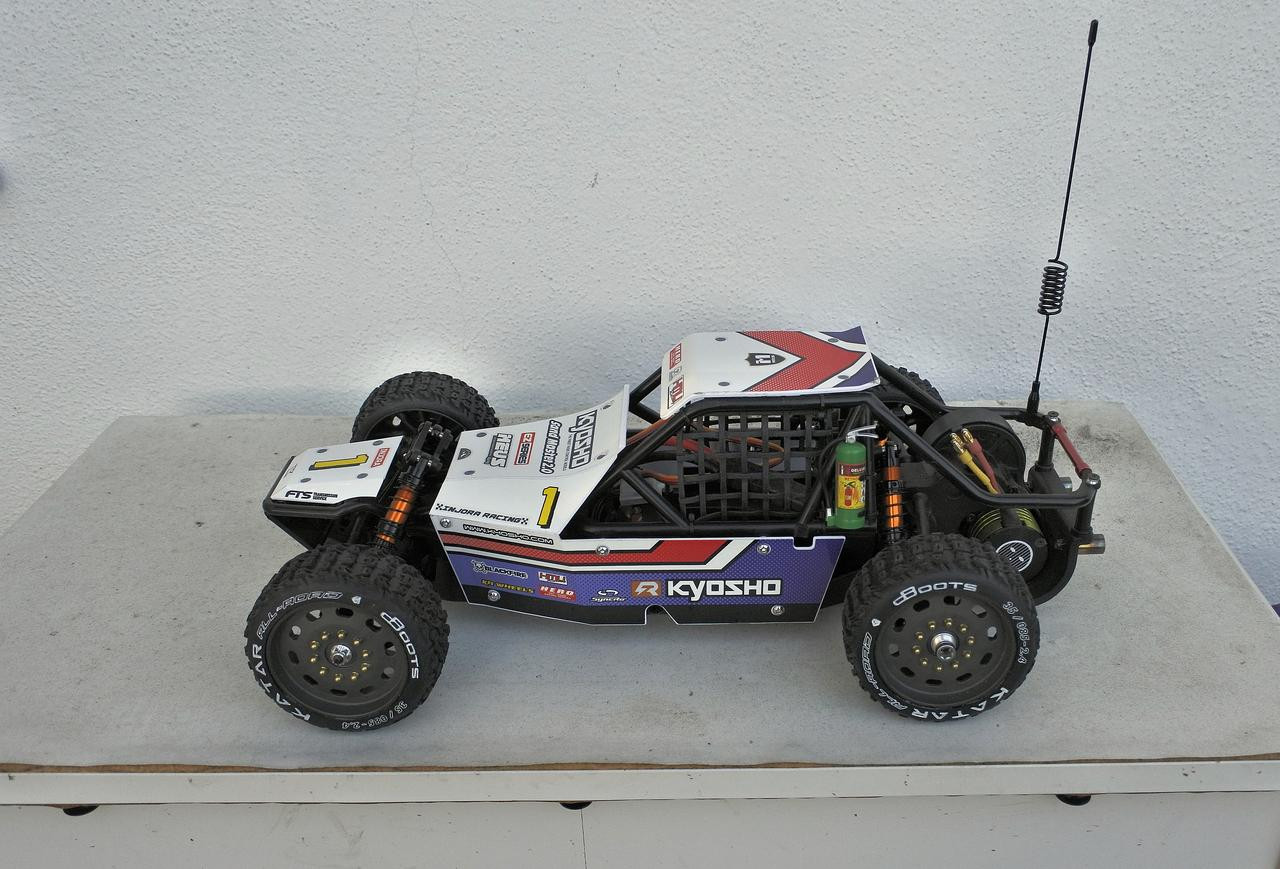

Is that just paint or did you dye the roll cage?
I was/still am a HUGE red, white, and blue fan.
That black chassis has transformed that buggy to the next level of most excellent!
