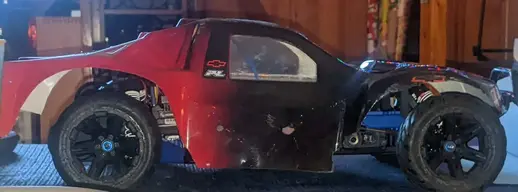

Last night I installed the new all black LCG chassis and put in the stock servo and hopefully I don't break those pegs again. I put in the rustler rear end since I put the 272R from the slash in the rustler. Right now it sits as a roller and will be used for extra parts for a few weeks until I can get motor and esc for the B74.

Your paint job reminds me of the old AMC racing livery. Pretty cool 😎
