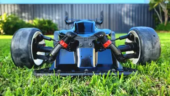

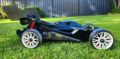

Started its life as a Typhon 3s. It's now running 6s (8s capable) with a HW max6 and is part Vendetta too.
Where do I start?
-Hobbywing MAX6 8s ESC
-Surpass Hobby/Rocket-RC 4282 2150kv motor
-CNHL 6s 8200mah 180c Racing series Lipo
-GRP 1/8 GTJ T04 Slick XM3 Soft on 20 Spokes
-Perfect Pass launch control
-RadioLink R7FG Rx. Range booster on Tx.
-DS 25kg servo
-Hot Racing servo saver
-Slipper clutch eliminator with 46t spur
-Suspension limit straps (as no droop screws)
-500,000cst diff oil
-Kevlar battery straps
-Vendetta Front splitter and rear defuser
-Vendetta front shocks and tower
-Typhon 6s shocks on rear with 4s springs
-CF spoiler wing extensions
-Center shaft bearing with alloy retainer
-Alloy pivot balls
PB speed to date:
115mph (6/1/24)
Future plans:
-Stretch it. XLWB chassis. Why? Because why not 🤣. It will also give the motor more space.
