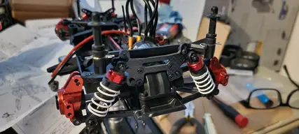

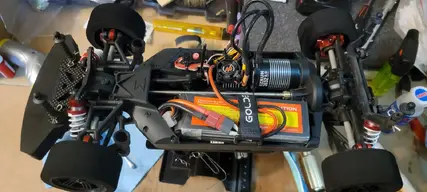

I have the Kyosho Fazer MK2. I have upgraded to FOAM wheels, aluminum shocks, metal center drive shaft, metal center drive cups, Brushless 5200kv & ESC, metal wheel hubs, carbon fiber bumper support and front/back shock towers. On 3s LiPo with 36t pinion.
The car is pulling severely to the left when I punch it past half throttle. I can ramp up slowly but, I still feel the car wanting to pull to the left at full throttle. With all the upgrades and work put into it all at one time, this is something that I'm trying to figure out since I didn't test between upgrades/rebuilds. I have replaced wheel bearings. I have rebuilt front and rear differentials with 30k silicone diff fluid. Checked shock oils levels and springs. I am thinking my problem is with differentials and fluid weight. Anyone have experience with differential weight oil should be using for On-Road 4WD RC?

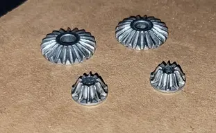

Thanks for the info guys. But I found the problem. The differential gears were worn down and not grabbing. At first glance you can't see the problem until you look closely at the gears and see the profile has completely worn down. I guess my homemade gasket was too thick and didn't seal correctly. Needless to say I had to order new diffs, gaskets and the diff housing for good measure.
Well good. I'm glad you figure out the issue :)
Yeah, if your gasket was too thick it would have given you a gear mesh that was too open, causing the gears to wear quickly. Best to stick with the proper parts there 😉

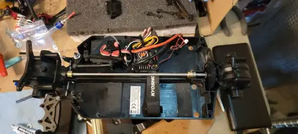

Received my Titanium Center Drive Shaft from KanizRC. Very nice quality and workmanship. I also received my new front and rear differentials, bearings, seals, gears & gaskets. Had to replace both diffs gears since I stripped them out. Basically, a complete teardown except the electronics. Putting 30k diff oil in both diffs to see how it acts. I got 10k and 7k oils on standby, but we'll see. Also need new foamies. My old ones are wearing.

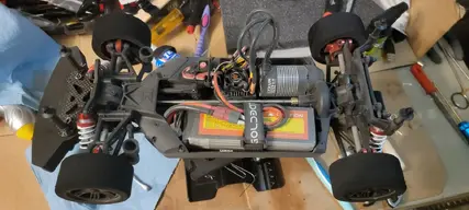

I had a small run tonight in my cul de sac with the Fazer. I got the new diffs installed and new foamies (Contact RC Racing Tyres 30mm 1/10 Nitro Sedan Foam Rear Tires I use in Front and Rear. 35 & 42 Shore 12mm Hex. I only have the 4 x 35 shore installed and it seems very quiet, fast and handles very SMOOTH. I rebuilt the rear differential and put 3k in the REAR & 30k in the FRONT and this configuration feels so TIGHT & RIGHT!
I'm going to try and make a video this week of the speed and stability. I got it a bit dusty just running on the street. But with an air compressor and a detail brush I looks very clean. TIP: Clean your RC.
