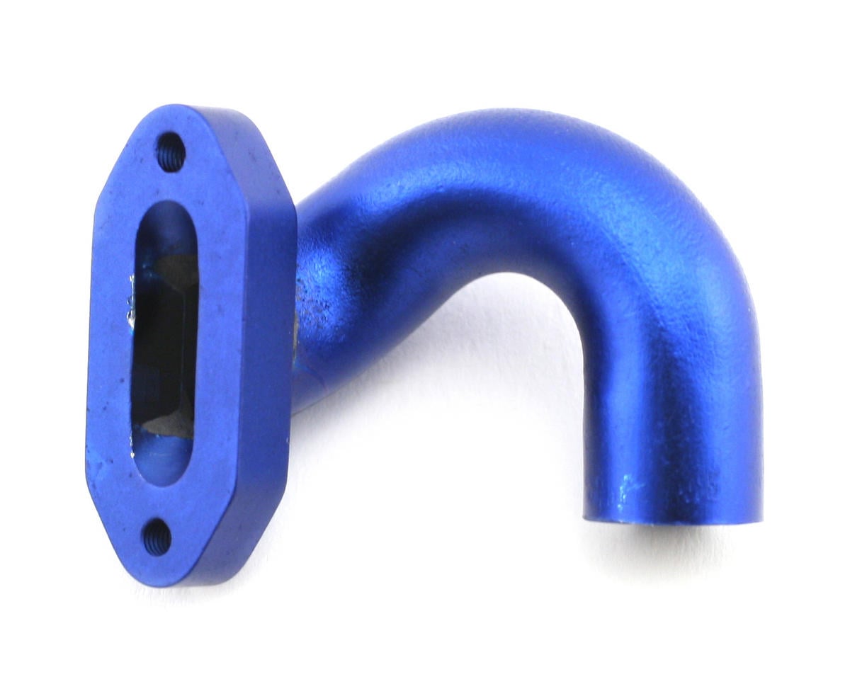

So I got the header on and exhaust going to test it out Sunday and play around with the gear change point , I did notice though that the exhaust header port is a lot smaller than what was on it , but it's the correct exhaust for that engine can nt16 fun factor. So will see how it goes and go from there lol

That header looks like it's for a big block. Won't hurt anything I don't think if it seals properly and doesn't leak.

hi thanks for chiming in ?
It fits ok and I sealed it up , I'm just concerned that the port hole in the header is smaller than the port hole in the block , thought they would be same size ?

small block and big blocks are going to have different size openings, I'm inclined to agree that header definitely looks like its Big Block-1/8 scale application.
might be able to look into a nitro 4-tec header?
the exhaust pipe(muffler) looks like it should work just fine.
as long as it runs good it should be fine, definitely not the engines optimal setup, but as long as its powerful enough for what you want.

That should be fine as it is. I forgot this one was a side exhaust engine with the long/narrow exhaust port on it. Some headers are built to fit then transition nicely to the tube, others don't. Some headers had a thick "plate" for lack of a better term, that the screws ran into from the other side. If you were careful, you could grind the hole in the plate to better match the slotted exhaust port. I can't tell how thick yours is, but odds are, you should be fine anyway.
You can see on this one how it's camphored in on the sides:

Yeah that's it ,kinda what I was expecting it to look like so was shocked when it wasn't, do you think its worth me getting the dremel out and grinding it back like the the one in your pic so it matches the port in the block ??
