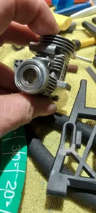

Well I decided to try and fire it up before I tore it down to have it run one last time before I spread it's internals all over the garage. I ended up spraying fuel in my eye and I'm so far ok. Found that I had really flooded the crap out of that poor engine... After I had spent 15min under the faucet I found that the driver was dead. Anyways I opened the rear of it up and in front of the crankshaft there seems to be no bearing? I watched some teardown videos and most you could see the ball bearing infront of the crankshaft. Also I need new gaskets and it seems like the engine is discontinued?
Well I decided to try and fire it up before I tore it down to have it run one last time before I spread it's internals all over the garage. I ended up spraying fuel in my eye and I'm so far ok. Found that I had really flooded the crap out of that poor engine... After I had spent 15min under the faucet I found that the driver was dead. Anyways I opened the rear over it up and in front of the crankshaft there seems to be no bearing? I watched some teardown videos and most you could see the ball bearing infront of the crankshaft. Also I need new gaskets and it seems like the engine is discontinued?
Oh I'm doing a rebuild on a discontinued RC. The parts are out there. I just bought a bunch of duratrax parts.... yes there should be bearings on both sides of the crankshaft in block. So if missing another reason fuel would be going everywhere bud.. you can get bearings I'm sure

Here's some pictures of what I found. Now it runs like crap. Not sure what else to do.
So the engine was gummed up, you did a complete tear down and cleaning, put it back together and now it runs but it runs like crap? Did I understand correctly? Sorry the details are a little fuzzy to me.
Define running like crap.
Haven't done a full teardown. But I found that it doesn't look like it has bearings. Then I bolted it back together because it looked fine but now it runs like crap. Can't hold the idle and sounds like it is going to blow the head off. I think I'm just going to have to take the long process doing a full teardown and clean and rebuild.
That would be the best thing to do. Everything was set back to factory? Does the engine have pinch? Was it knocking? It doesn't look that bad. Was the right plug in? Sorry have to ask..
