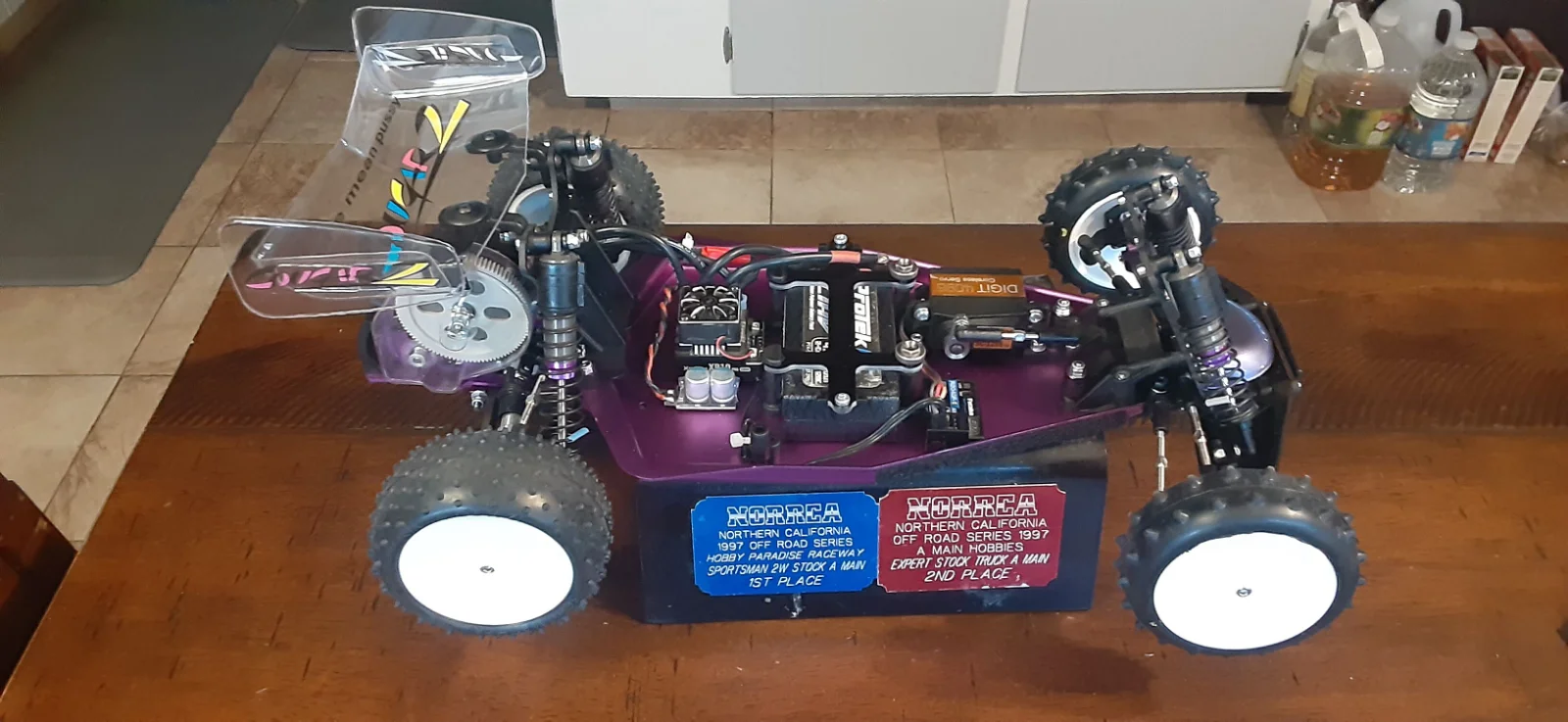

Finished the build and added a few upgrades also I always wanted a works version I raced schumacher cars throughout the 80's and 90's but could never get my hands on a new kit until now hope you like it.
It can be quirky if not set up properly, It really shines on outdoor tracks like Hot Rod Hobbies
Yeah the chassis kept bending and the motor mount situation is a poor design with it slotted top to bottom instead of front to back so it kept moving and stripping spur gears. I think I got that stuff solved with the new chassis brace and the 3d printed insert as well as some serrated motor washers! Definitely handles real good and is easy to drive on a real offroad surface! I beat a bunch of modern buggies at Hotrod with mine ;)
