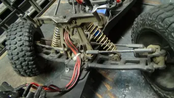

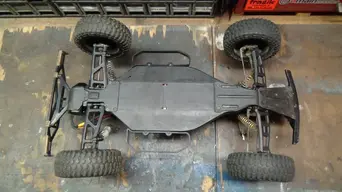

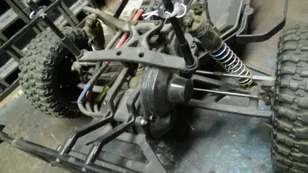

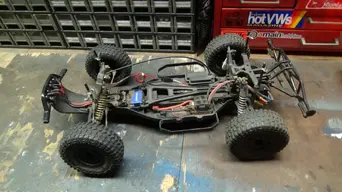

not a big fan of short course trucks. this has been an attempt to get one to drive/handle/bash like a stadium truck. results are "meh". the Baja bug body doesn't "float" as bad as the OG truck body. iv got a Pro-Line Megalodon body i still need to paint. that should help even more.
wheels are Pro-Line Raid's. tires are Pro-Line Hyrax's.
electrics: stock radio, generic el cheapo 3800kv 4 pole motor, Castle Sidewinder 3 ESC, can't remember what servo i used... battery is whatever 2s lipo i slap into it.
chassis mods: RPM front chassis brace/front bumper. RPM front and rear suspension arms. AE CVA's.
custom: made my own LED harness to wire up the lights on the bumper.
