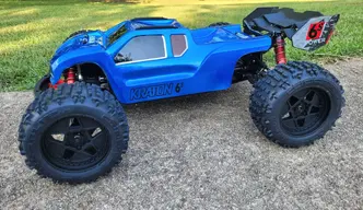

V3 Arrma Kraton 6s. Hobby Wing Max6 G2 ESC 4990SD motor. Dual aluminum offset rear chassis braces. One Kraton, one Notorious. Front aluminum chassis brace. 7075 top plate. Power HD 50kg servo. JBI solid servo mount. Treal 7075 steering system modified for quad flanged bearings on the ackerman & 12.9, 4mm socket head shoulder screws thru the ackerman bar. Titanium pillow balls. RPM arms. Avid titanium domed droop screws. Fireteam hexes. Custom 7075 T651, 5.2mm thick front shock tower I CNC machined & 4mm standoffs. Treal triple bearing front & rear hubs. All 5 aluminum hinge pin holders. 60/500/30 diffs. Proline Enforcer body. LP Backflips.
