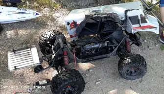

I was using a cheap charger that I had set up incorrectly a while back and almost burned my SUV to the ground. I recommend going to YouTube and looking at battery/charger videos. You'll be an expert in no time 😜.
This was the aftermath of the battery explosion in my Excursion and almost cost me dearly.
