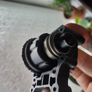

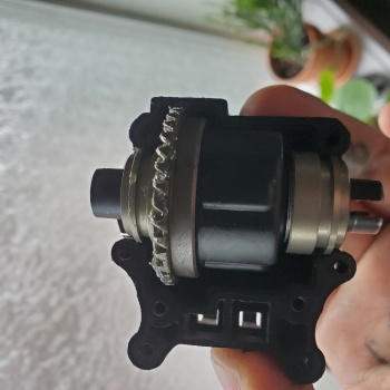

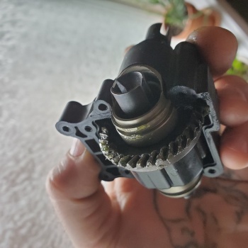

I'm getting ready to change out the diff oils. Is the easiest way to get to the front and rears diff by removing sections at a time - bumper assembly, shock mount assembly, etc.?

@brushlessrc I re-oil my bearings after 6-10 dirt bashing runs. It's easy to do and only needs a few drops. Good practice to get into.
With your diffs, it is just a matter of pulling things apart. I like to take screws out about half way and make sure they stay in the spots they belong as I remove parts, that way I know exactly where they go when I put it back together. I take pics of everything too in case I need a reference.
I just installed those aluminum rear outdrive bearing cups. They snapped in perfectly and my diff didn't need any shimming from what I could tell. Did the grease test and it also feels like the motor gear mesh, not loose but not too tight either. Looks to be a solid upgrade 👍🤘

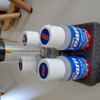

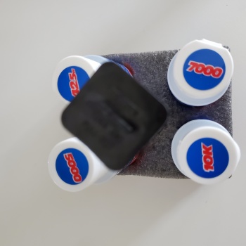

I cut out foam for all my oils I use for a specific RC model. I've got diff oils, shock oil and bearing oil for the DB Pro in this one.
5k front, 10k centre, 7k rear (E-fanatic set up 👍)
42.5 weight shock oil (little stiffer for bashing)
High velocity bearing oil
I've got FlexyTub shock covers coming so I don't have to change my shock oil so much hahha.
