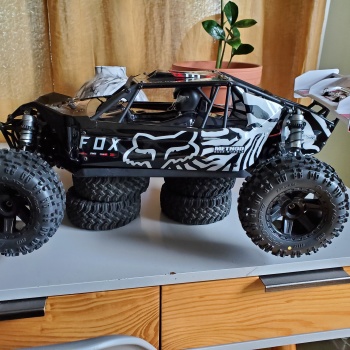

New Losi tenacity DB pro
Pulled the trigger.
Losi Tenacity DB Pro Lucas Oil
Spektrum DX5C Transmitter
2- Spektrum 2S 50C Batteries
Spektrum S2100 Charger
Savox SW1210 SG Servo
Radio box
Skid plates
Tire glue
Sure adds up quick
I think I have it all for now. Will be rolling next week. ?

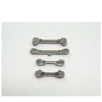

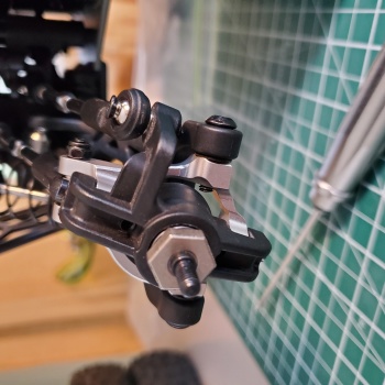

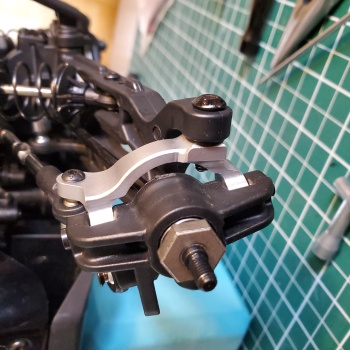

Well the chassis braces for the SCTE do not fit our Tenacity buggies. I bought STrc aluminum braces for the SCTE and they don't fit.
But...

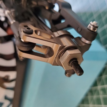

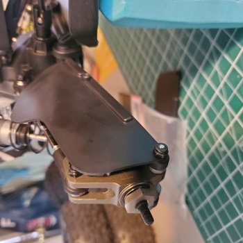

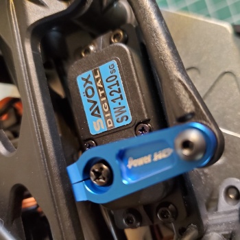

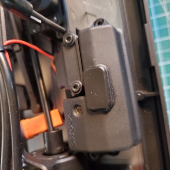

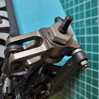

I installed the DE mudflaps, aluminum rear hubs, front spindles (front knuckles are sold out EVERYWHERE), Traxxas waterproof receiver box, Savox 1210Sg servo, power RC clamping horn, steering assembly bearings, premounted proline badlands and RPM skid plates do fit.
I'm stoked at the difference in the steering and the tires!

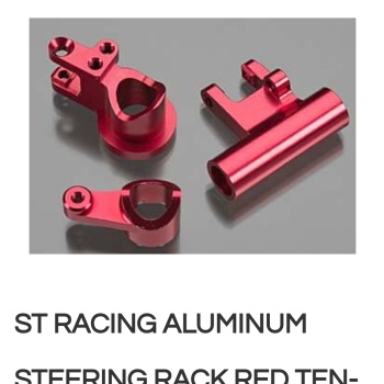

Have a few questions about fitment since I've wasted money buying cross platform parts before.
Will this STRC steering rack for the scte fit the tenacity?

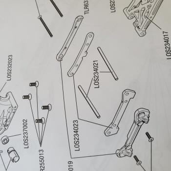

I'm looking at these hinge pin braces for the scte 3.0, will they fit the Tenacity?
If those do fit, do I need the plastic bits as shown in the below kit? I do not see them in the parts assembly diagram. I do not want to buy the upgraded braces and find out I need those plastic bits.
Thanks!

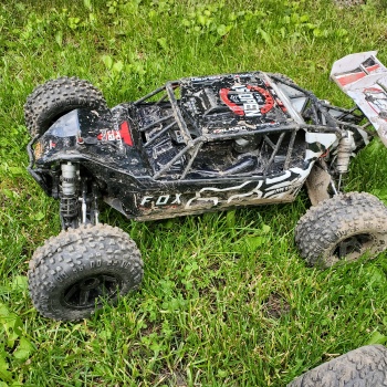

Great day in the dirt and mud today. Those rear mud guards and the Traxxas water tight receiver box sure came in handy.
Tore the DB down after and cleaned everything, dried everything, regressed and oiled. Feels good to check all the components of an RTR, making sure everything is to spec.
