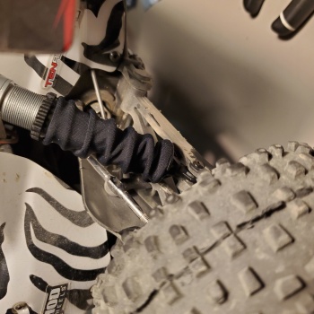

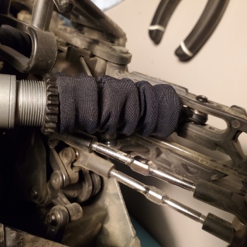

Changed my shock oil over to 42.5 weight. Decided to give these covers a shot too. Cheap and easy to throw on, might lengthen the time between fluid changes too.
what is the stock oil weight used in the shocks? Thinking of putting in some heavier weight because for me it bottoms out too easily
I think it's a 35 wt.
I adjusted my ride height and droop so it didn't bottom out so bad when I had stock weight. I bash on rock/gravel heavy off road terrain so the clearance was needed. The 42.5 definitely helps with clearing bigger jumps for sure.
