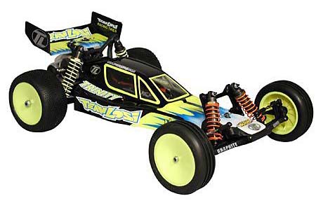

Looking for wheels that fit a 2000 Losi xxx buggy. Does anyone have suggestions? Are there mods to fit today’s wheels?

he's asking about a "2000 Losi xxx buggy" which is this.
I completely fabricated SCB in my mind there because I have been seeing them listed on ebay a lot lately 🤪
Carry on 😁
