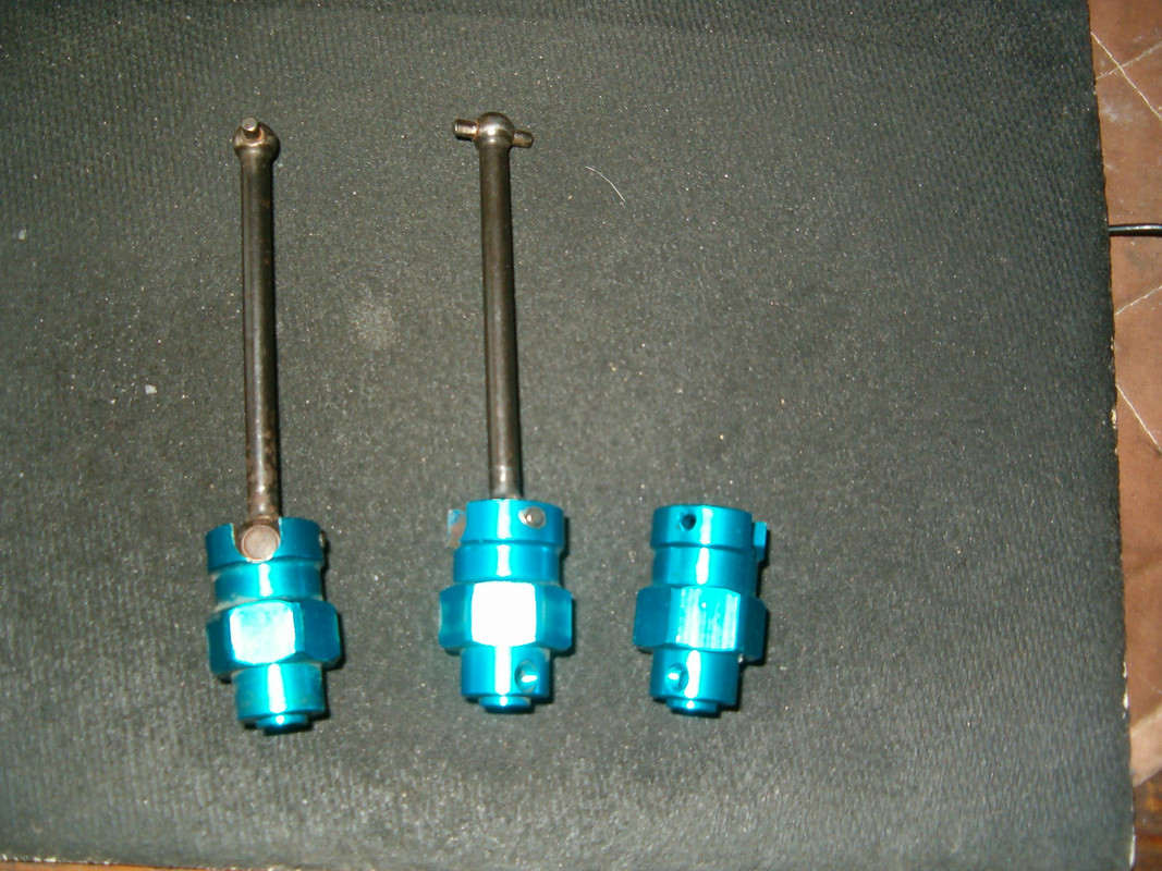

Yea ,mine did ,an I switched to the Mips ,I just came from there ,but only found bits & pieces.
The hub on those are steel an not aluminum ,so they don't wear out!
I have my originals ,an they look brand new ,but these aren't the one that had been on my basher.
I am not going to use them ,I have 3 fronts ,but haven't been out to the shed yet to find the rears!
Here is what I have extra ,2 with good shafts on them ,an 1 that is new but no shaft ,an I will
have to go look in the shed an see if I have any rears!

I might cut loose of one with the shaft & the one with out!
Those were just in my box that I take with me out in the field for spares.
I need to go out to my shed an gather up every thing together to see what all
I do have ,I have a couple boxes of Mgt parts ,but can not remember!
