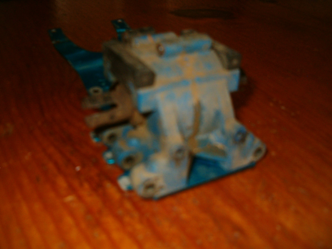

Oh ,here ,this is the weak spot!....:cool:
That was an issue with the stupid t-maxx too. Why they didn't capture the front/rear of the pins with an alloy plate, I'll never understand. I went through bulkhead after bulkhead on that thing. What sucked, is if you did upgraded to alloy bulks, the trailing edge of the arm still floated in behind the bulk and would bend the hinge pin. Then you had to fight to get the pin out of the bulk.
Was a goofy setup.

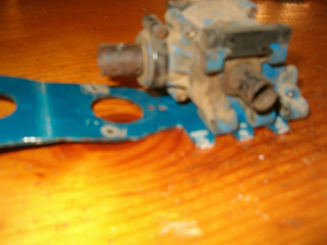

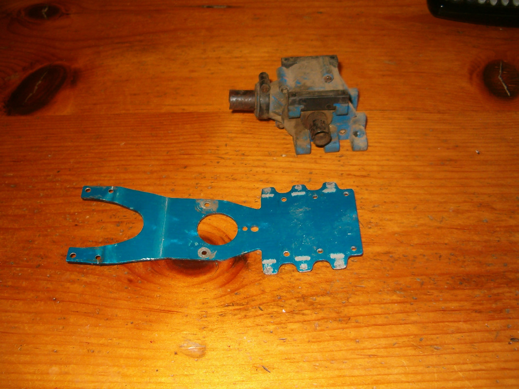

I am looking at my old front skidplate ,which I flattened out an used it as a pattern for the custom made skid & diff now
It might be just feasible to just make a little support bracket plate that goes end to end where the pin enters and to where
it exits!
The plate bracket could slide under the diff. in between the diff. & skid plate ,the only change ,is that it will lower the
skid plate about a 1/16 to 1/8 in which isn't too much.
When I made my front skid ,it was thicker an it altered my steering ,but I put a washer under the steering post
to take up the slack!
I had made a similar support bracket for my baja on the shock tower ,I will show pics of that later ,it will give
an idea of what I am talking about!
Here is a pic.
