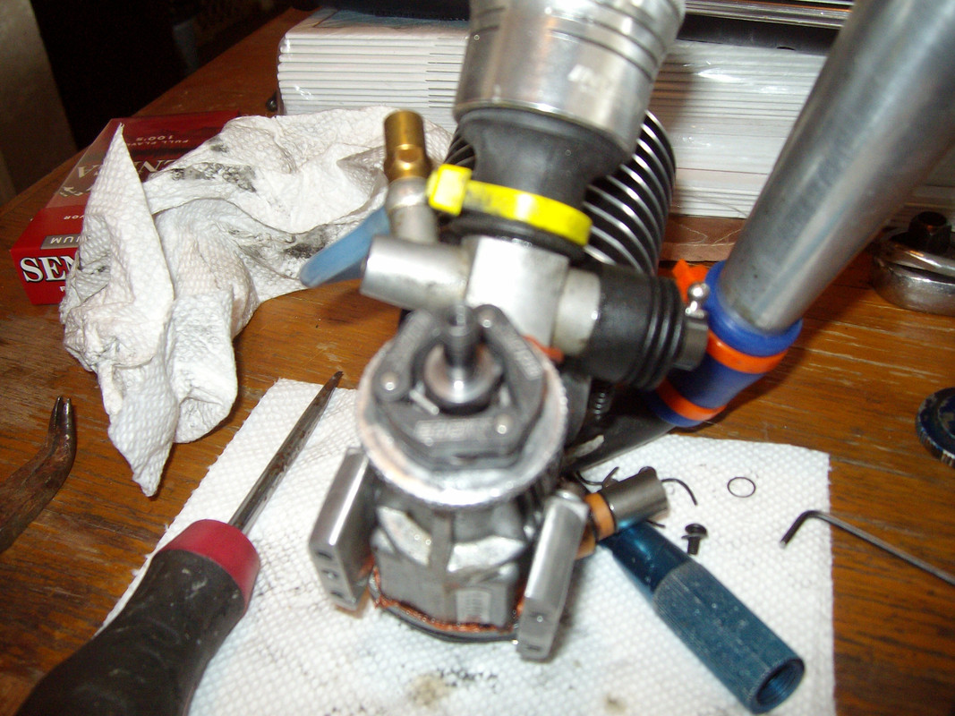

On my street car with the 21 size engine ,the brand is racers edge an on the basher ,they are an Ofna brand ,there
is plenty Ofna alum. shoes on E-bay!
Here is a pic ,not clear ,an all 3 alum. is on there ,they are the Racers edge,but on my truck ,I do have 2 alum.s an 1 comp.
