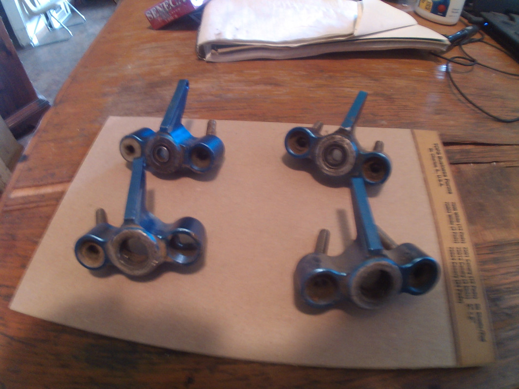

Here is some pics of mine ,they will be cleaned up an put on the shelf queen ,I am putting the
original ones back on because I don't want them destroying my new F.E. bearings!
well those look familiar :P.
Olds, they do but the pillow balls and studs are different, so you have to get new ones. if i couldnt get these aluminum ones to work again thats what i was going to do.

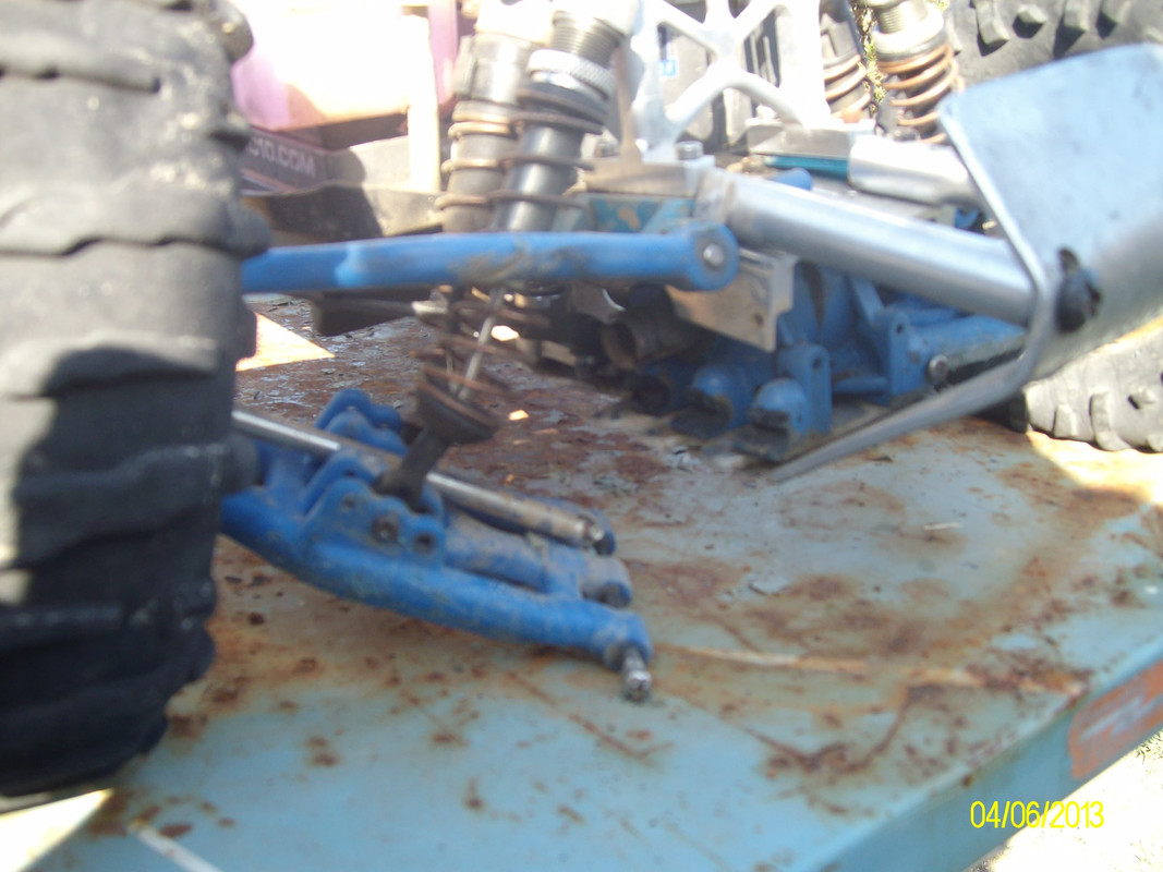

I remember when I first bought my Mgt brand new ,I hit a tree full blast at a park ,it didn't even faze
the truck!
They are tough trucks ,however ,their weak spot ,is were the a-arms connect to the diff ,so you might want
to invest into a couple of diff. housings!....:cool:
yeah, luckily have not broken any yet, but in the 10 or so years owning this thing, I've only ran 3-5 tanks in the HPI K4.6 motor, and barely broken in the axial.28, so very little drive time. is there a company that makes metal dif housings for these? or would that be a not good idea? felt like a kid again running this thing... just realized i started a thread for this truck but never even put any pictures of it up yet... ouch that looks like that hurt a bit ^, I'm curious if it would be smarter for me to run replacement A-Arms vs finding Rpms? seems that if i ran stock they would break before the diffs? or was it an issue without rpms too?
i like that bumper/skid btw, where you find that at? or did you make it?
