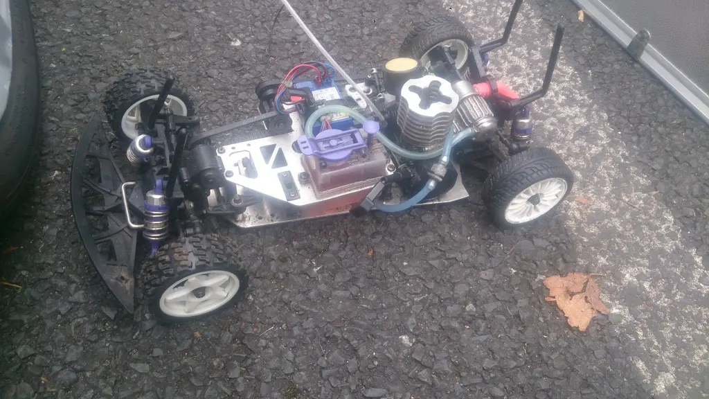

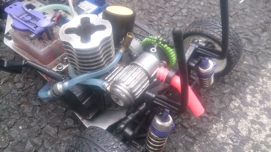

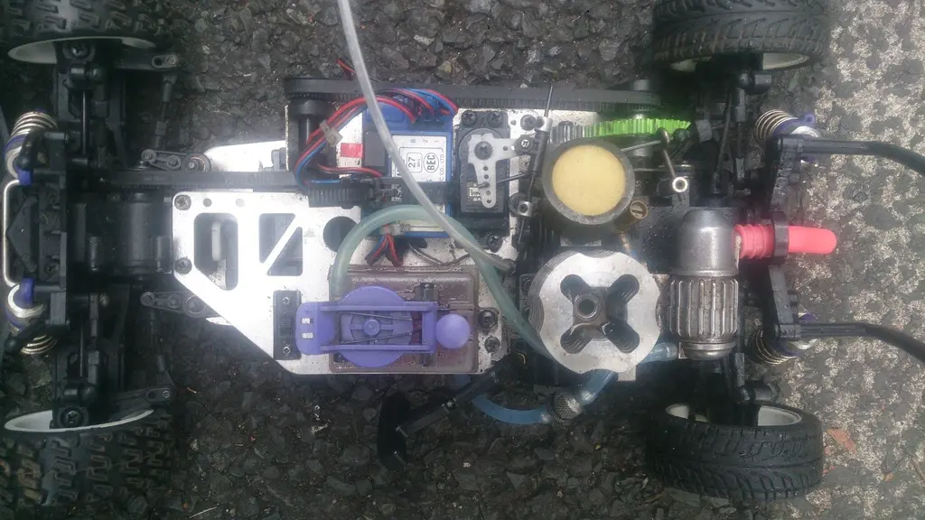

Hi there everyone.
Recently my brother acquired my dad's old Nitro RC car, and was all excited until he didn't know how to start it. I think it needs some new parts, however we're unsure of the make or model of the car, and so we just wondered if we could pick at some intelligent brains and see if anyone has any ideas as to the identity of it?
This is the RC Car in question:
Any and all suggestions will be greatly appreciated!
Thanks,
Myles

From those pictures, I've identifed the receiver as a Futaba FP-R122JE 2 ch. 75MHz AM receiver:
UPDATE:
I think this is a Tamiya, as the engine is a Tamiya FS12 SW. Thanks for that
It also looks slightly like a thunder tiger TS4N- The way the fuel tank is mounted (well, the location)@olds97_lss
I tried looking for old tamiya vehicles, but couldn't find any exactly like this one. Looked similar, but the pipe wasn't ever the same, so not sure if I saw the vehicle or not.
This one's difficult- it might just be a mish mash of parts...
The thing that's annoying me the most is that I've found an ebay listing for this exact one, but he didn't know what it was...
DONE IT!!!!!
It's a CEN GX1!
2 hours I've spent searching for this one- no joke...

It's a CEN GX1

Since it sat so long, odds are all the o-rings are dried up and should be replaced. I don't know if you can replace the ones in the tank plunger, if not, I'd get a new tank and not even try the one on it. The other o-rings would be in the carb.
If I was him I'd do a total overhaul- engine, diffs, shocks- although it may not be necessary. As long as fun is had, then that's all that counts.

As for an overhaul, my dad actually got it running some time last year i think, but i agree it could do with new parts. What would be a logical way to go about this, as in if i was to buy the engine and tank for him, and then find it still doesn't run, and so could possibly have spent unnecessarily on parts.
I was thinking if i got him a new fuel tank, fuel lines and a new glow plug and components for each, it would help diagnose any other problems that could be wrong with the car.
Is my logical thinking worth it? or is it completely pointless? :D
