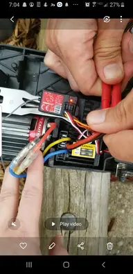

Hey guys, newbie here. I just recently purchased an XTE Blackout. Already went with a LIPO 2s 7.4V 5000Mah upgrade from the stock NIMH 7.2V 3000Mah. Ran fine for a while, today it overheated and started smoking. Turned everything off and let it cool. Took it apart and took pictures of how wires were connected to the servo. Hooked it all back up and now the car accelerates full throttle as soon as I plug the battery in, with the car being in the ON or OFF position. It doesn't matter. Never ran into this before. Also tried to check continuity with the switch being ON/OFF and nothing would register. Any suggestions?

Yes I will, upload pics when I get home from work today. I have switched it to LIPO mode, I made sure of it. This is the 3rd time I've ran a battery through it on LiPO batteries. To my knowledge the remote is not broken. Also the remote is not on when it does this. Everything is off and go to plug the battery in and it just goes full tilt.
This is the picture I took before I took it apart last night.
I'll get more tonight, and better in focus. Lighting was terrible last night.
The, whole car without body, motor, esc, reciver and radio
I forgot to reply with a pic. I think I got it now
If it runs in the off position you might have melted a wire or two. Check everything, ESC and the on/off switch, to check that the wiring is still intact.
The on/off switch appears to be double sided sticky taped on. Nothing seems to appear melted from what I can see externally.

Are you sure the esc isn't turning on as soon as you plug the battery in?
I know this is late advice, but its important to watch the motor and esc temps while your playing to make sure they don't overheat. Get a cheap laser temp reader (https://www.amazon.com/General-Tool...646&sprefix=temp+reader+rc+car,aps,153&sr=8-3) and just check motor and esc every 10 min or so to see where your at. I try to keep motor temps below 160 max and esc lower than that, maybe 120. If its getting hot enough to smoke, thats way beyond those temps and you might need to gear down a bit to get it to run cooler.
If your switch isn't shorted and the wires coming out of the esc aren't melted, then you've likely damaged the esc.

All I know for sure is that the switch to my remote and the switch to the car are off and as soon as I plug my battery in it goes. I tried to turn the controller and the car on after it had already went full tilt but nothing can control it other than disconnecting the battery.
