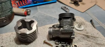

UPDATE ON THE DURATRAX MAXIMUM MT RESTORATION
PARTS CLEANING
This was one of the worst kept RCs I've seen. With sheet rock screws and finish nails as hinge pins. 🤦🏻‍♂️
So I stripped it down to bare chassis every screw and plastic piece..IN ORIGINALPOST.. Then put all plastis in a container with simple green. And soaked for a few days. Then dumped out and then WD-40 and SG together for a day.
All the aluminum were thrown in a container with white vinegar. And sat in there for about 30 mins. The torq .16 engine was broken down into pieces as well.. then cleaned with simple green. The shocks were also stripped down oil dumped and bodies cleaned.
To my surprise the engine didn't look to bad. Will rebuild it see if it fires.. ordered a bunch of parts for it as extra parts.. So this is were I'm at now. Almost ready to rebuild..this is how it's looking so far.
Once the aluminum was taken out. The aluminum will most like turn black or discolored. At that time used dremel. To buff out the aluminum parts to bring back it's shine
Then took all screws put them in white vinegar for about 15mins. Then put them in a container with . BLASTER DRY LUBE. Then with demel wire wheeled every screw.
Broke down shock drain oil out cleaned bodies. And the interior with a q-tip..
The bearing in SG then blown out with air compressor. Then put into dry LUBE to soak. Then taken out and cleaned with microfiber cloth
Tha
After breaking it down. And freeing
up the crankshaft with heat gun. Then the engine was cleaned with SG and wire wheeled. And polished.
Now to wait for other parts to come in and the rebuild will begin. Hope the above can help anyone. That would like to break down and clean thier own RC....

Where did you find that? At the bottom of a lake? Good work so far, looking nice.
It might as well been. Got from a guy at work.. thanks man 👍👍

The parts came out great, nice job..
Thanks bud 👍 few hrs a day after work then sat and sunday... But finally got them clean. I'm meticulous when it comes to a RC break down and cleaning...

Those parts are definitely looking a whole lot better!
Yeah they are. The shocks are like new! Threads like this make me want to tear stuff apart 😁

Yeah well I put some time into those little bastards... here's my crazy insane meticulous trick ready............ clean with SG and a brush then a dermel and rubbing compound and then mothers aluminum polish buffed out with dremel....
Did it with all the aluminum parts.. that's why no video very tedious and meticulous work. Most RCers won't go that far. With cleaning a RC the way I do it... 👍👍😜🤪😜🤦🏻‍♂️🤦🏻‍♂

My gawd man! They are new. One helluva job bro. Yeah, I woulda watched lol.
