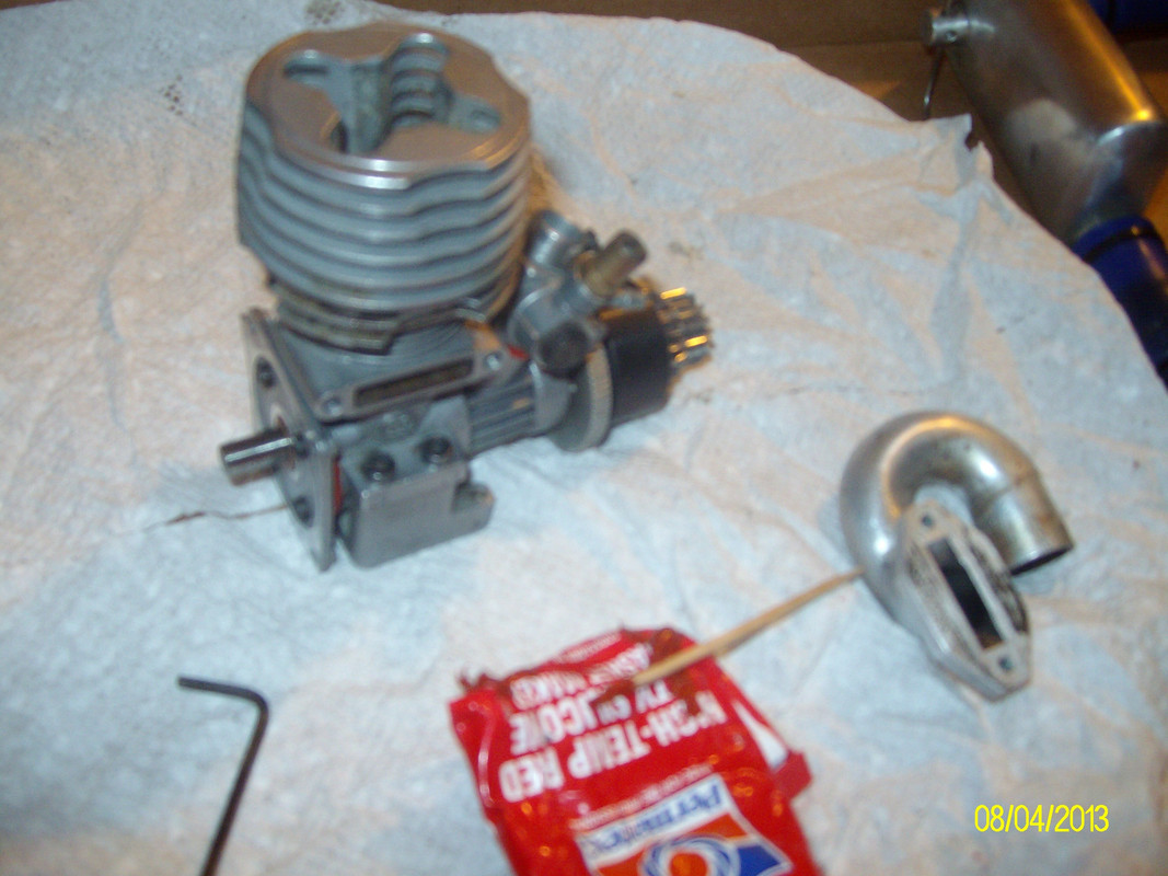

My exaust manifold screws were loose.
A leaky exhaust would cause the engine to lose some pressure in the tank causing a lean bog ,an also
may cause the engine to die at full WOT!
MY other screws re tight. I did tightnen the exahust right before my best run. It did keep running lean, even when really rich. I think that is the problem. I don't think they were ever really tight to begin with, but just got looser. I did crank down and tighten them. I will get a plug for it today. Probably 2.

I have tightened the exhaust and installed a new glow plug. I think it is the screws that hold the plate that holds the crankshaft. The one under the pull start. It still died out even after the exhaust and the glow plug. No fuel lines are blocked. Since this Rc has had issues from the factory, I can assume it is that plate being loose.
Air leaks can cause poor performance in the engines tune ,some people like to seal the engines backplate &
carb. throat!
I tightened the backplate. The flywheel was more difficult to turn afterwards. I will check the carb tomorrow.
If your engine feels a little tighter ,then it maybe holding more pressure as you turn the flywheel ,that maybe
where your air leak was!....:cool:
