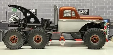

I have been working on this idea for a while. I want a tow truck. To go along with the Darkhorse Garage.
I like scale but I am really into crawling. So I want to build a tow truck then can not only climb rocks but can survive a fall from five feet down a rock face. Not an easy thing.
But I think I got it figured out. And to make it better I’m going to build two.
I really really like my G Speed Power Wagon with the 3D printed bed.
It has a 2.0 low trans from Team Garage Hack and nice ar44 metal axles. It climbs really well and I like it. So I decided to build another one with six wheel drive and make them both tow trucks .
The whole tow rig will be self contained and held to the bed with nylon bolts. If it tumbles down a cliff. It will just snap off the bolts. And I can also just remove it when I want to craw without it.
The orange photo is my current build. The orange and white 6x6 is my inspiration. But I’m going to go a bit further toward performance. And I have a great idea for the boom.
I found a new out of the box Trx6 for portals. That’s the first thing I need. Then I need to sell the perfect white body. Still has the plastic protection. Body and chassis minus running gear $150.00 plus shipping. I won’t have it till the 18 th of anyone is interested.
