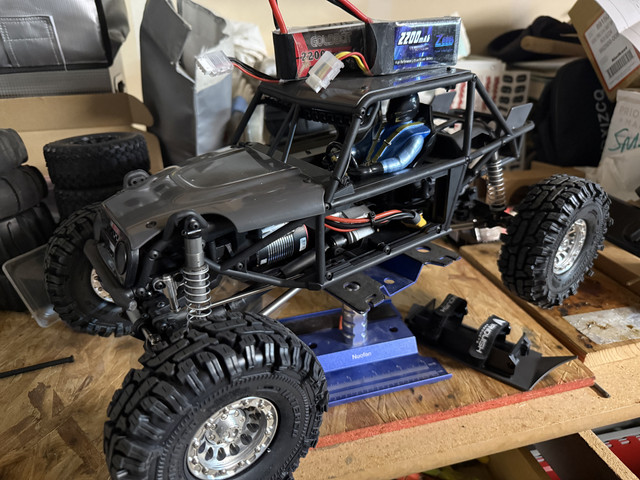

I am considering installing a light bar and headlights on my H10 Optic. I know there are a lot of variables such as motor, tires, vehicle weight, and terrain being driven, but how much shorter could I expect my runtime to be, roughly. I will be running 1800mah batteries, with Holmes crawlmaster 2300kv motor, right now in all stock configuration. Just trying to figure out if I want to go with the lights or not. Night driving sounds like a good time. I guess if runtime is shortened too much that just means carrying xtra batteries. Thanks for any help!

Just the info I was looking for. Thanks! I think the small tradoff will be well worth it. I am on the lookout for 2200mah packs that will fit the Optic. Found a pack on Scamazon but looks like long delivery time. Sure would be nice if 3200's would fit.
