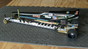

Something like this work for you? Reworked 1/2in aluminum angle used for the frame on my R4E dragster, back 2009. Home Depot purchase, then onto the drill press for a bit of lightening. As I recall, used the thicker 1/8in for the frame rails and thinner 1/16in for radio, battery and ESC mounts. Cheers. AC

Thats a pretty cool build!
