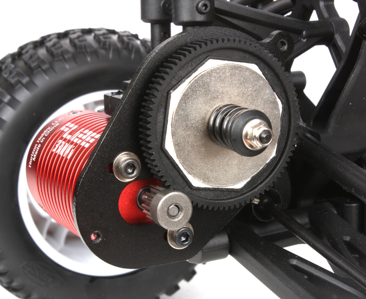

Since you stop one wheel and they all stop says the back half of the drive train is solid. The motor spins freely. Which means it's probably in the gear box some place. There "might be"a slipper clutch in the gear box. It will be on the spur gear, attached with a nylon nut and have some sort of plate on it. Something like this.
There is no slipper in WPL.
