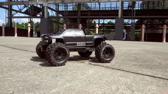

So heres the idea for the truck. You all let me know on how realistic the idea and if its possible. NOT the HOW yet. Please. Too much info overloads my eyes lol.
LOOK: Just as this pick looks... I'm really looking for the Jacked Up Truck look. Which I'm almost good with how it looks. other than some paint and true cosmetic things.
USE: Badass bashing!! Flipping and all that is way off still. Not really gonna ramp it yet. So a ground a$$ kicker.
WHERE: Mostly park area. Lots of big grass hills. Very short grass. Lots of sidewalk transitions. * why I wanted to raise truck in first place* under tree dirt areas. And a little just back and forth pavement running. i dont have any good dirt areas around so far that I've found. No rc tracks.
Will it wear on parts sitting the truck up this way?? Maybe putting harsher angles on driveshafts tie rod ends etc??
This is possible and you might be able to reposition the shocks (if the Big Rock has multiple mounting points) so they are more vertical which will give the kit a little higher stance. If you want to do anything more drastic than that its going to take a lot of works find parts from other kits that are the proper length. For example you may need to find longer shocks, longer CVDs etc. Heres the big downside to that. The higher you jack that kit up the higher your COG (center of gravity) will be which means its gonna feel more top heavy. Its also going to negatively affect the performance of of the suspension. So basically if you made it look like its got a huge lift kit under it its not going to corner as well as it used to. Hope that helps.
Oops so I see I forgot the pic last night. I was beat. Worked the last 18 of last 21 days. Not a young buck anymore.🤦.
So here is What it looks like now. I run the stock rear shocks in front and ZD Racing 110mm in the rear. No need to raise anymore. The look of it I'm good with now.
