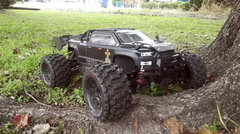

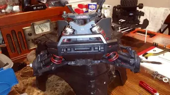

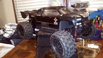

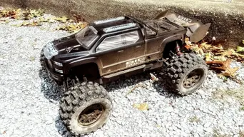

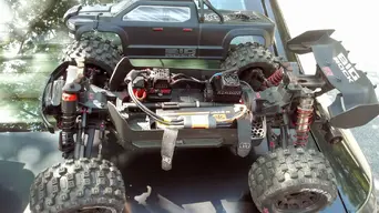

So she is my very first Hobby grade RC. I got her during the pandemic to cope with the crazy life that was happening around us all. Of course, she was a stock rtr new out of the box. I was 1 of the not so lucky...servo trashed 1st day. Followed by some advice that I shoulda passed on lol. And multiple newb mistakes. I finally am getting close to what I was hoping it would be.
So we'll start with whats on her now.
Proline badlands 2.8unbelted.
Hr pivot balls
Hr servo saver/aluminum arm
Granite front bumper
25kg amazon servo
Front shocks are rear stock
Rear are 115mm ZD Racing (Wanted the jacked up truck look)
3d printed roof skids/nose plate
4s roll bar
Custom decals
12mm hex (going to 17mm)
Typhon mega wing/mount
Hr motor mount (m2c hopefully soon)
Stock motor and wax (want to run 4s on low temp).
Will update as I upgrade. Getting a new slipper assembly from Jennys RC.com Friday. Then back up and running. 👍

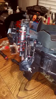

So a little update. The rear diff atill kicking my a$$. A nice guy on the Arrma Forum sending me an extra rear yoke to swap mine. Still locking down when put in chassis. Idk. But I did get the front of the truck put back together with Granite front bumper 6s ZD shocks. 105mm. Axial bushing. Gonna end up leaving rear shocks stock till I can get CVDs atleast. Too much rake on the driveshafts. And my 12mm hex. Only cause I didnt wanna run adapterz anymore. Seem to add lits if wheel wobble. I will end up at 17mm hex and hubs

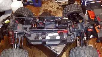

Well guys and gals if ur out there. After much trouble and frustrastion and pissed offness I think Betty is ready to ride. Everything feels smooth. Went thru locktited new places and re did and cleaned old.
ZDs 110mm front shocks. Stock rear. New slipper assembly. New rear yoke provided by a really cool guy on Arrma Forum. Got some really rad decals I'm putting on tonight. Charge the battery tom and we will see what happens. New servo saver. New stock steering assembly. Really tightend it up more than I thought! They are built a tad different orig stock.

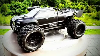

But here she is MY BLACK BETTY!!

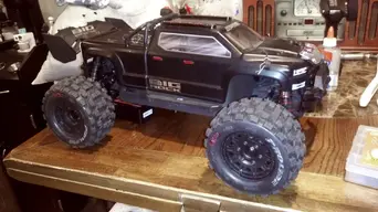

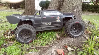

Oh yea!! Runs like a Beast again!! Did take it a bit easy. At first! Wanted to make sure all my Noob repairs or as they should be. My first therapy and weeks feel like the world's been lifted off my shoulders 😂💯🤷
Awesome! Everyone needs RC therapy! :)

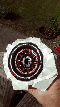

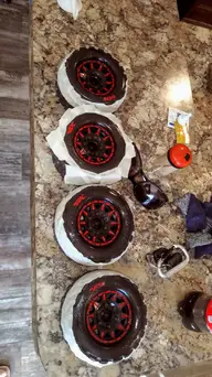

Nothing big. But finally had time to finish painting and just sprayed clear coat. I like them. Its no prof job by any means. But who can tell when ur kicken dirt at them??🤘
