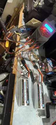

Do you have a electrical meter? Or a battery capacity checker. Like either of these?
You can use them to check your battery charge levels.a full 2s 7.2 lipo should be 8.4 at full charge. Each cell will charge to 4.2.

I borrowed a balance charger from the bro in law ( he has the same truck ). I charged the smaller pack, and the larger. Both continue to do the same thing. On the new 5200mah I’m reading 8.39v total, 4.2, and 4.19 on the cells. I ran it for like 3 minutes in the house and it cut out. Cycled power on the truck and it came right back on. I’d attach a few short clips, but it doesn’t look like I can. Only photos.
That esc is the problem then
