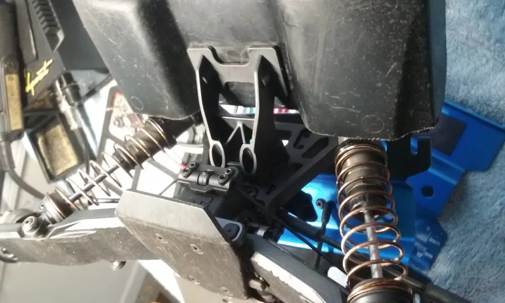

I was going to test everything with stock parts. After reading about turf guys having bulkhead issues, my main concern is the front bulkhead snapping. I thought I'd just go ahead and add some extra insurance. I had Trinity's camber plate bulkhead saver laying around; staring at me...on she went. Why wait to put it on? Right?
Exotek Racing makes a camber plate bulkhead saver as well. I just think Trinity hit it out of the park with their bulkhead saver plate. The chamfered silver edging/black anodizing is right up my alley.
I had to come up with an alternative mounting spot for the receiver since the BIG ol' WP-SC8 won't go on a weight loss program. I don't know how the Futaba FASST compatible receiver will hold up. I just could not bring myself to buy the $79 R603FF receivers each time I want to use my trusty 3PM radio to control another RC.
I went ahead and put on an aluminum servo horn, because the more I thought about it, I didn't want to hear, "I told ya so." :naughty:
