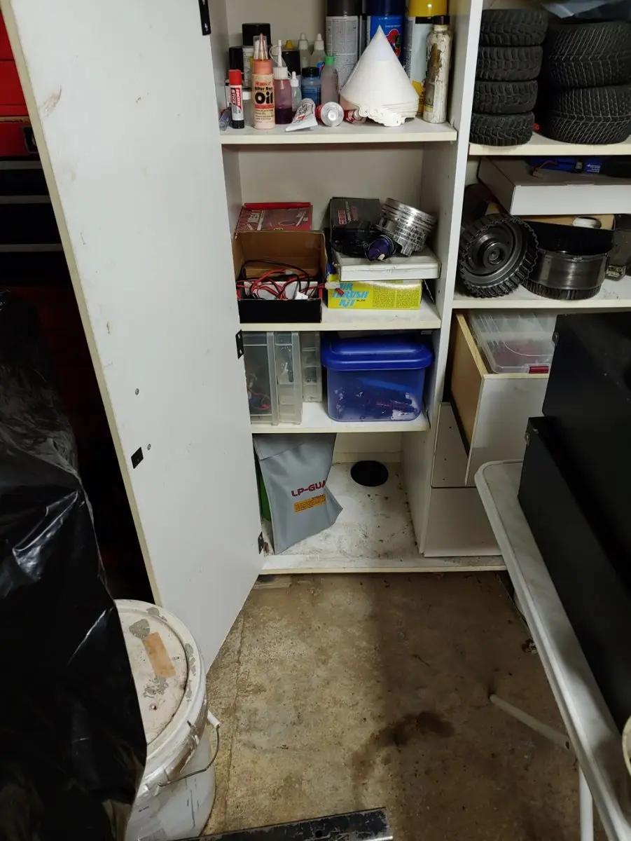

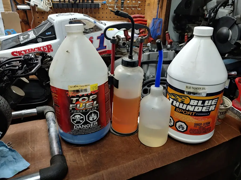

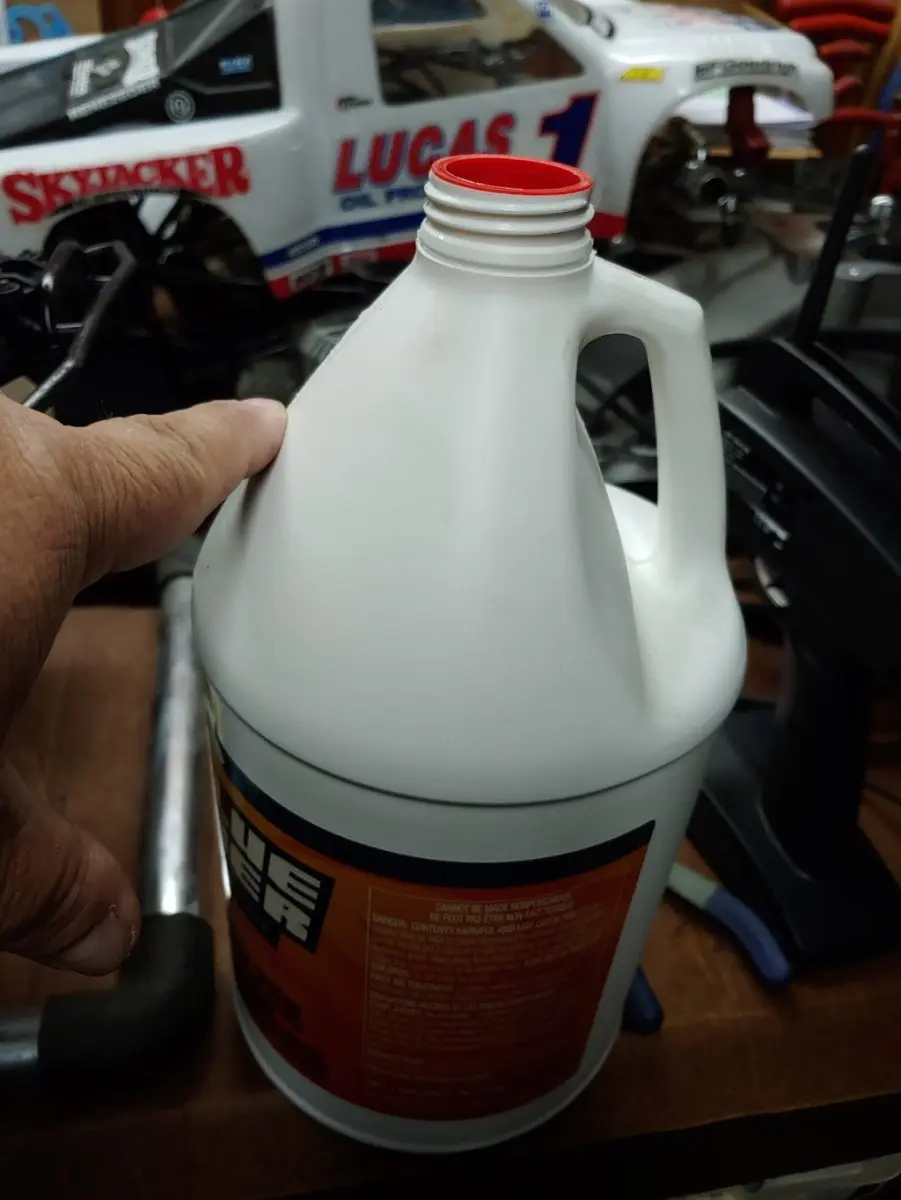

First off all I have is old fuel. I have a little Byron's 30% in a fuel bottle, even less of some Losi Nitrotane 20%, about a 1/2 gallon of Traxxas 10% and a brand new bottle of Blue Thunder Sport 20%. The Losi fuel has no zing to the smell so I know it is no good, I am pretty sure it was bought in late 2011. The Byron's is also flat and I have no idea how old it is but older than the Losi fuel. I honestly don't even remember where I got the Traxxas fuel, I don't remember ever buying 10% fuel. Then there's the Blue Thunder. It is a new/never opened bottle but I bought it several years ago and never used it. If the date on the bottle is a manufacture date then it is from 2013, if it's a "best by" date then a little older.

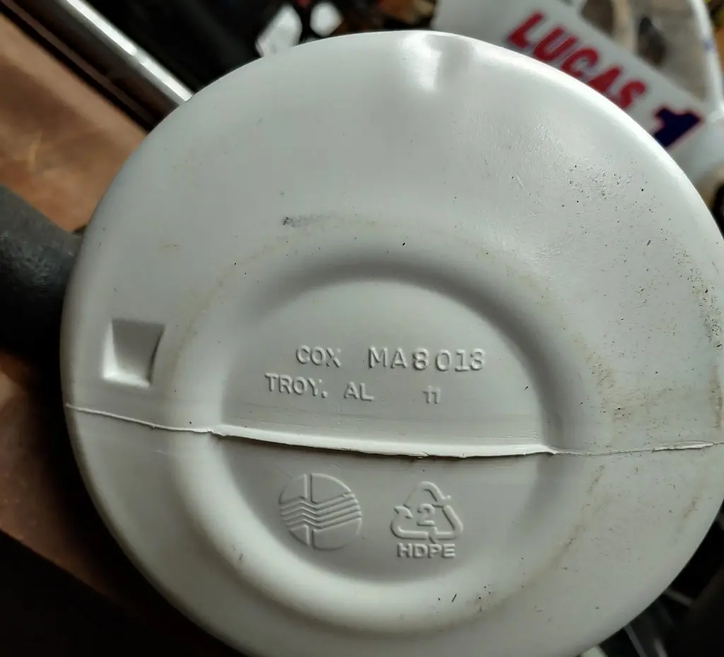

If that isn't a date then I don't remember for sure when I bought it before November 2016. I say that because that is when I bought my Mustang project car and dropped out of the rc hobby. I also know many of you guys think you can't run old fuel too but that is basically bs. If stored properly, it will stay good for a long time. I have ran 10 year old fuel with no issues and I have no doubt that the Blue Thunder will run. The Traxxas smells like it should run too but I will probably never find out. Here's a pic of the cabinet in my garage where the fuel has been stored. The red plug is still in the neck and my finger shows how full the bottle is.

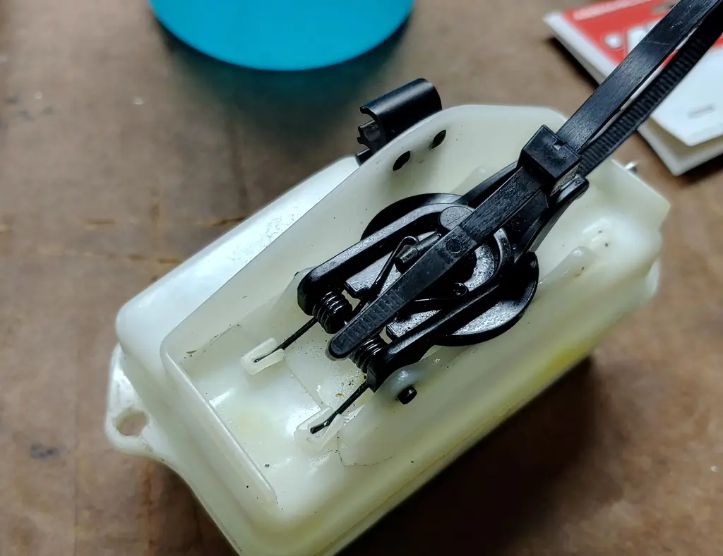

But as I stated at the start of this post, we aren't going to find out today if the fuel will run. I rechecked the charge on all the batteries, dumped the Losi fuel and filled the bottle with the Blue Thunder, filled the tank on the truck and prepared to start it. I pulled the fuel line off the carb and ran it to a cup, put a plug in the exhaust and the starter shaft in my cordless drill. I engaged the starter shaft into the motor and gave it a spin. I was immediately greeted with fuel spraying everywhere except out of the fuel line. A quick check revealed that I somehow overlooked a big crack in the top of the fuel tank! 😲 :eggface:
It appears the constant pressure from the spring holding the cap closed has fatigued the plastic so it cracked. Some searching shows I am not going to easily find a replacement either. I will let you know if I find some and try again to run this thing.
