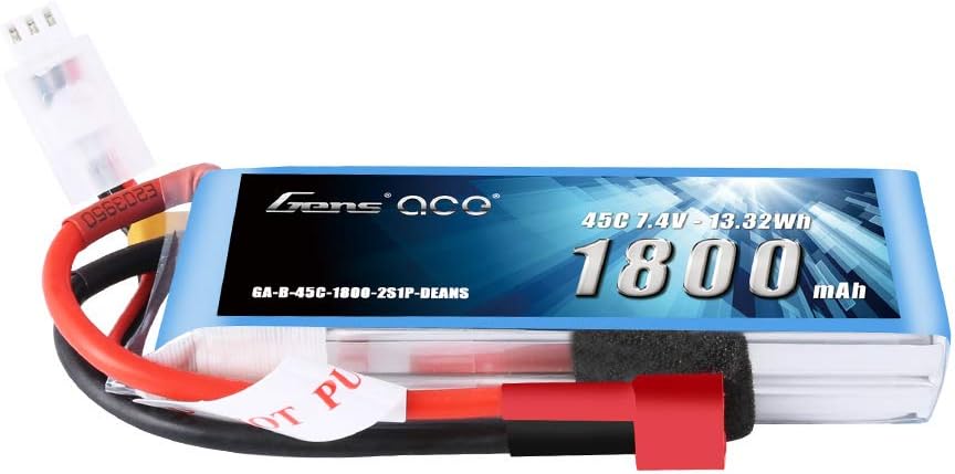

I've been able to find all the parts I was looking for ..... Aluminum A arms , shock towers , arm mounts , etc.... I had one of these yrs ago and before i got out of the hobby i upgraded it to brushless.... so i know done correctly it will hold up to brushless power .... may have to put a new aluminum spur gear in .... which i can find ....
But I litterally just 5 mins ago ..... ordered 2 of theser batteries !!!! and then i just ordered the hobbywing exrun combo a1 for it ..... so we will see shold be here in a couple days ..... I also am changing out the RX/TX .... I have a noble nb4 .... and they have some really small Rx .... so i am going to use one of theres
