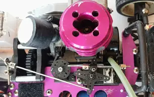

I have converted one of my car from a rotary carb to a barrel carb. Please see picture attached. Your milage varied.
