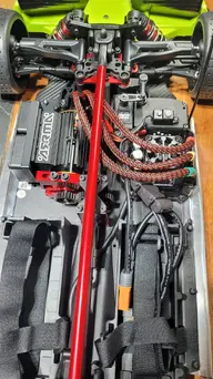

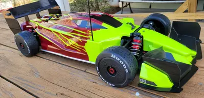

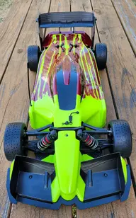

Arrma Limitless V2 Lightning roller build.
General RC Information

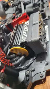

TP4050 1950KV motor.
Dual 40mm motor fans- custom 3d printed adapter mount I designed in Fusion360.

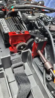

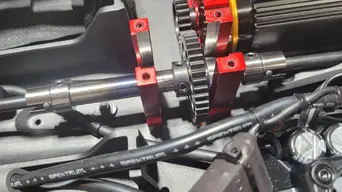

RamJam titanium spool & 39t Perfect Pass gear.

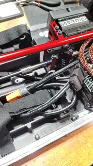

160a Spektrum Firma ESC.
Spektrum SR6110AT receiver.
M2C +3mm rear axle driveshaft dogbones.
Hobao 6mm center driveshafts.
Tekno input drive cups- bulkheads.
Tekno 23t pinion.
100k front diff fluid & 80k rear.
Power HD 25kg digital servo.
Ruddog 7075 servo arm.

Setting up the spool. Takes a few times of assembly & disassembly to get the stack correct.
