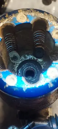

Should not be corroded.probably 5-10 minutes. yes it's in. It doesn't look damaged, maybe a little corroded/dirty. is that normal?
After you are done running your after oil clean up, pull the glow plug and you can see the piston go to the bottom, stop there.Ok. Is there a way to check that without taking the head off?
