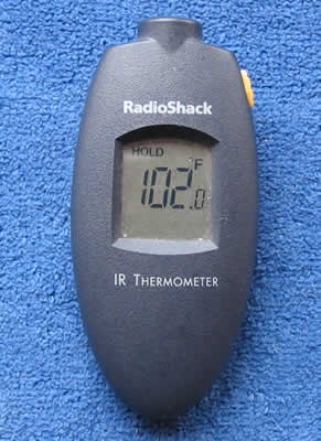

I got one from radio shack many years ago for about 25
I've had that one for 20 years, or likely one similar:
Pretty sure it was $50+ though back then.
