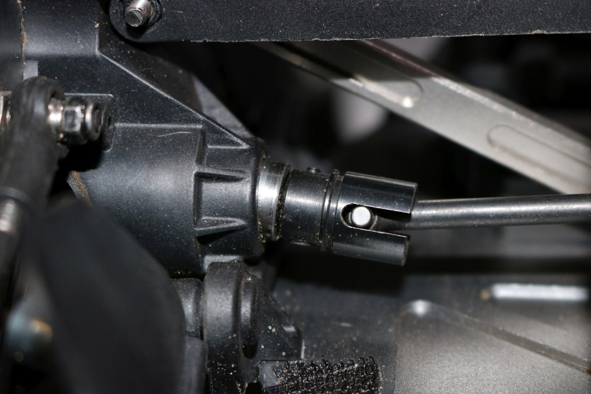

You are correct about the diff case bearing. I just received a new diff set and it uses a larger diameter bearing. I think the OD is 13mm for the new bearing.
Regarding the grub screw, the grub screws are only used to attach and hold the center coupler in place on the pinion diff gear shaft. Look over the parts diagram in the manual and it should help explain. The Tekno outdrives are assembled the same way as the stock outdrives. Remember to place the bearings on before assembling the diff as the bearings don't fit/slide over the Tekno outdrives.
