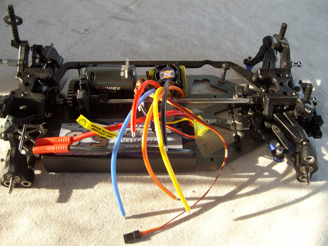

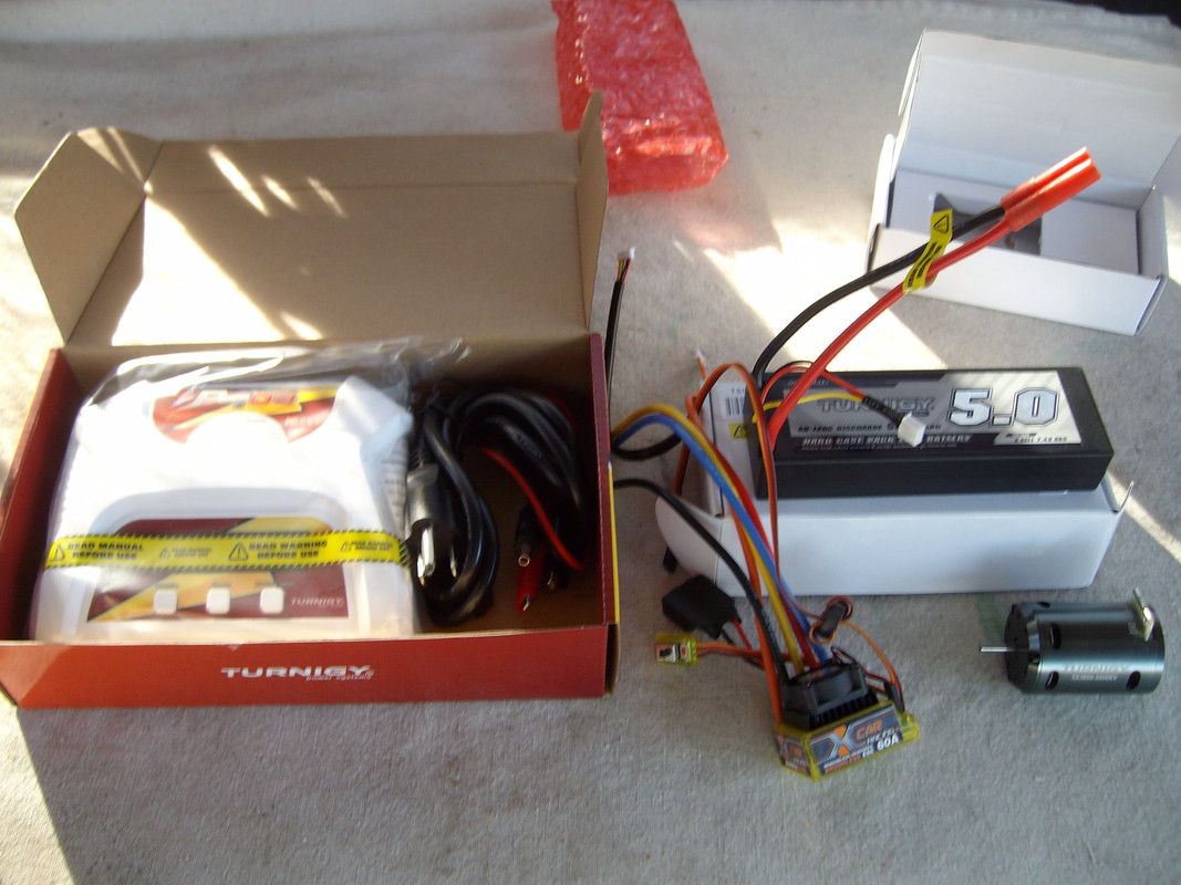

I am not too keen on electrics & the cheap products that is out there on market ,however ,I did build one ,an did use a cheapy!
I ran 3's on a cheap 60 amp ,it did ok until I had totaled the car ,then after that ,the ESC didnt work no more ,I think that
the hit killed it though!
I think that it would be ok if you monitor the heat ,an make sure that it can handle 3's ,an also watch out for the gear
ratio ,certain gear ratios can create heat!...:cool:
But I would wait awhile ,an get more opinions about it!....:thumbs-up:
