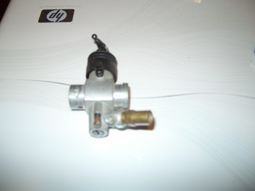

The Hpi 5.9 is a good engine once that you get to know it an its weak spot ,the composite carbs are a weak spot ,
that aluminum housing that is screwed or pressed on the plastic carb housing is also prone to leak ,it is a very
poor design in my books ,just can't beat a solid aluminum carb.!
This is the carb that I want to put on mine!
