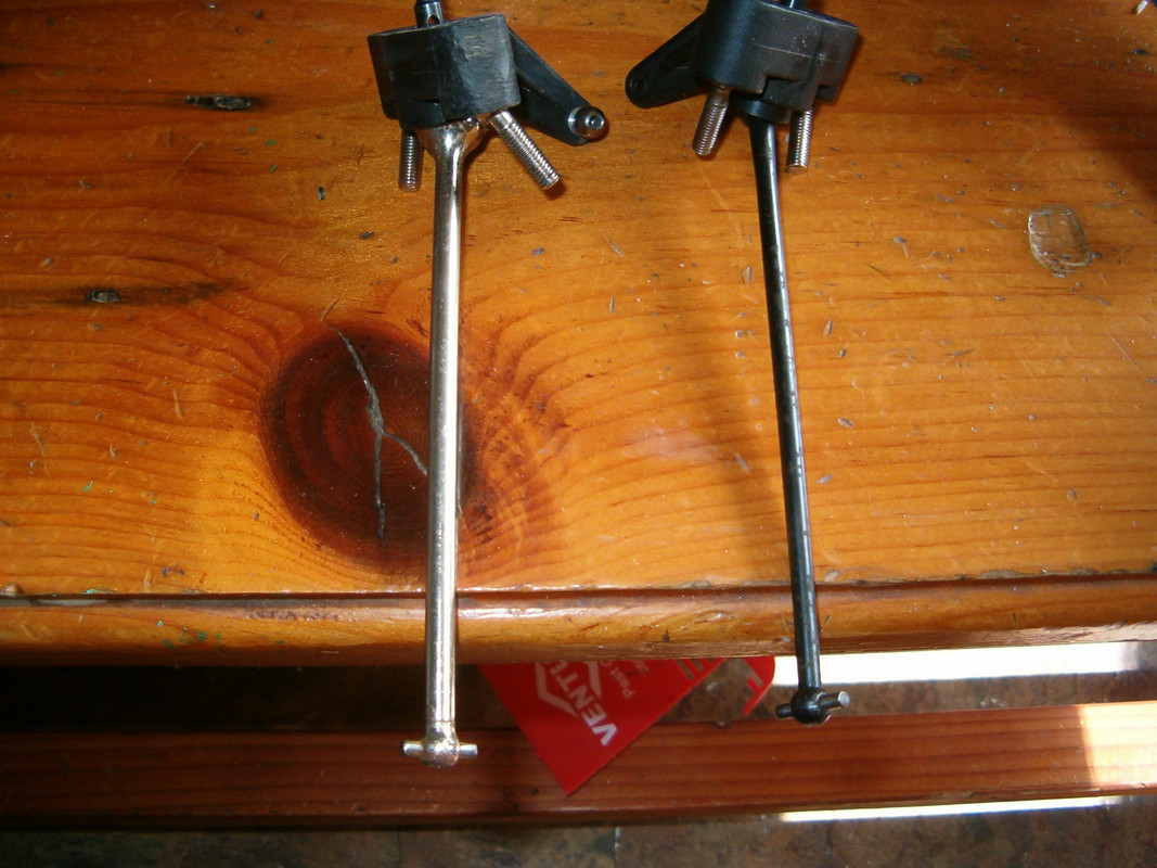

I learnt the hard way ,an destroyed one of my MIP superduty axles ,it shattered the pin hole!....:doh::doh::doh:
Mip put out some super duties ,you can see in this pic the difference!
Oh wow that's a lot heavier duty! I want to get some of those, If I can find them, I just got the center rear for now as a b-day present.
