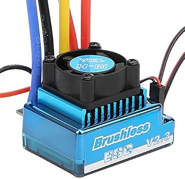

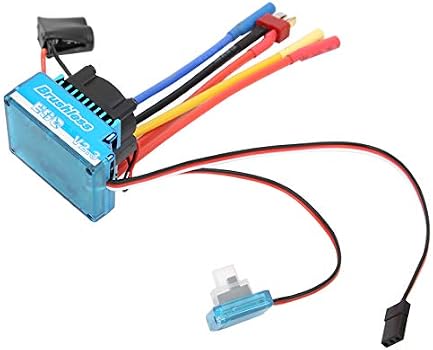

Brand: fuwinkr
Brushless ESC Electric Speed Controller Waterproof Dustproof Brushless ESC Electronic Speed Controller for 1/10 RC Car Model((120A))​
  1. Brushless ESC Electric Speed Controller Waterproof Dustproof Brushless ESC Electronic Speed Controller for 1/10 RC Car Model((120A))

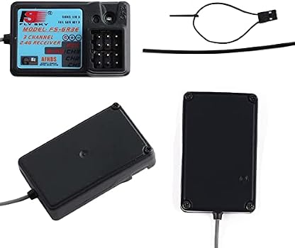

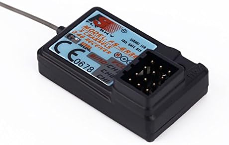

Flysky Upgraded Waterproof FS-GR3E 2.4G 3CH Receiver DC 5V for FS-GT2 FS-GT2B FS-GT3B FS-GT3C FZ-IT4S RC Car Boat Transmitter​
  1. Flysky Upgraded Waterproof FS-GR3E 2.4G 3CH Receiver DC 5V for FS-GT2 FS-GT2B FS-GT3B FS-GT3C FZ-IT4S RC Car Boat Transmitter
And a Flysky fs-gtb transmitter. And the turning worked fine after I switched recievers this issue has shown up after everything was working fine

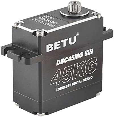

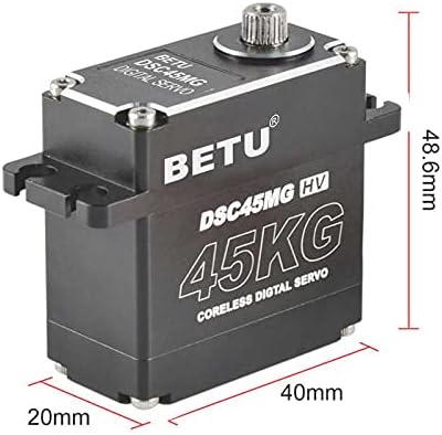

I'm pretty sure this is the servo I'm using now, I'll double check in a sec and unless I correct myself, then it's this servo:
BETU 45Kg Coreless Servo Motor HV 8.4V, High Torque RC Digital Servo,Full Waterproof Servo, Stainless Steel Gear Servo with 25T Servo Horn(180°)​
  1. BETU 45Kg Coreless Servo Motor HV 8.4V, High Torque RC Digital Servo,Full Waterproof Servo, Stainless Steel Gear Servo with 25T Servo Horn(180°)
Oh and the transmitter is actually a Flysky FS-GT2B I was mistaken earlier

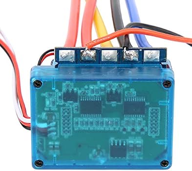

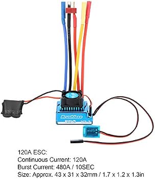

Are you still using that ESC? Just curious, because I thought they were the normal ones that I used to get, but not so. There is no way to do throttle calibration... no setup button on the switch, or on the ESC body itself. I returned two of the ESCs that you pictured as they gave me nothing but trouble. I could not get them to work correctly.
The 120A ESCs with the red setup button on the switch are the one I normally get if wanting to go ultra low budget. They setup and work like a Hobbywing ESC and also will work with their programming card.
