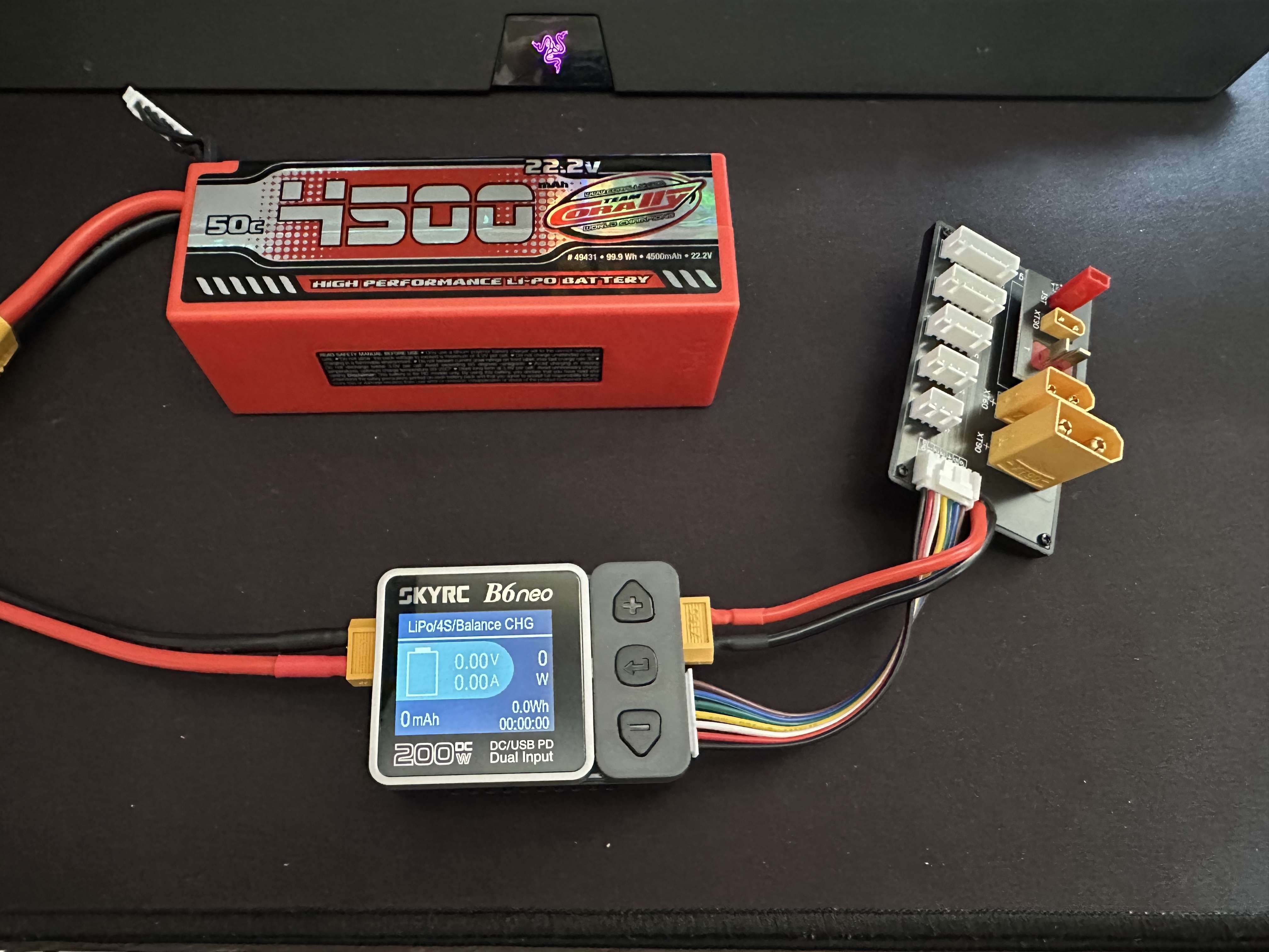

If you told me 10-15 years ago that one day we would be able to field charge with a charger the size of a pack of gum being powered by a 6S lipo....

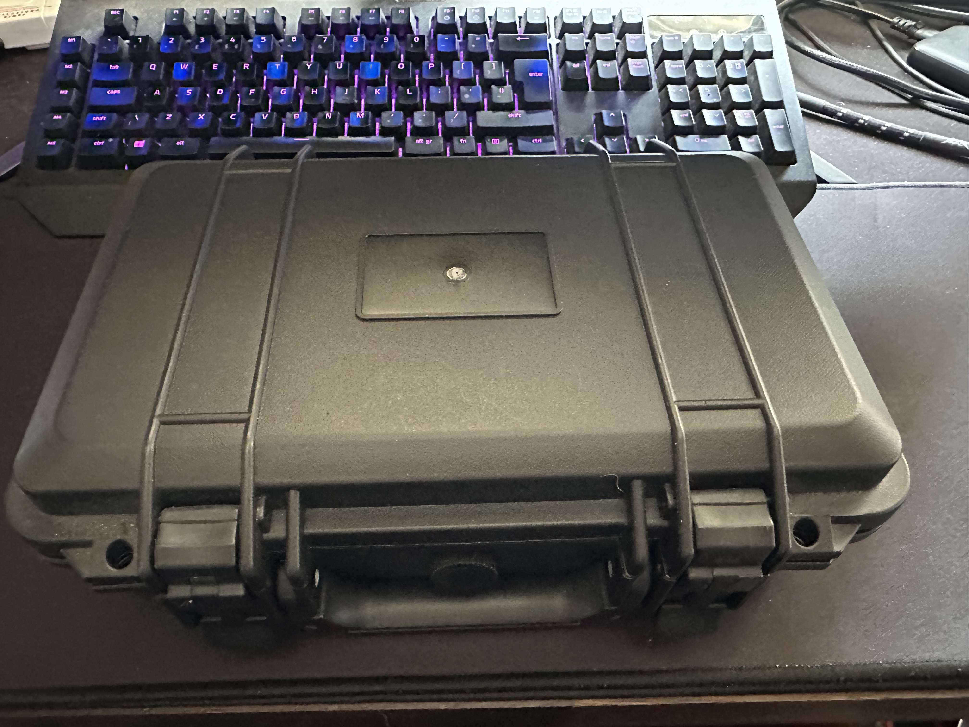

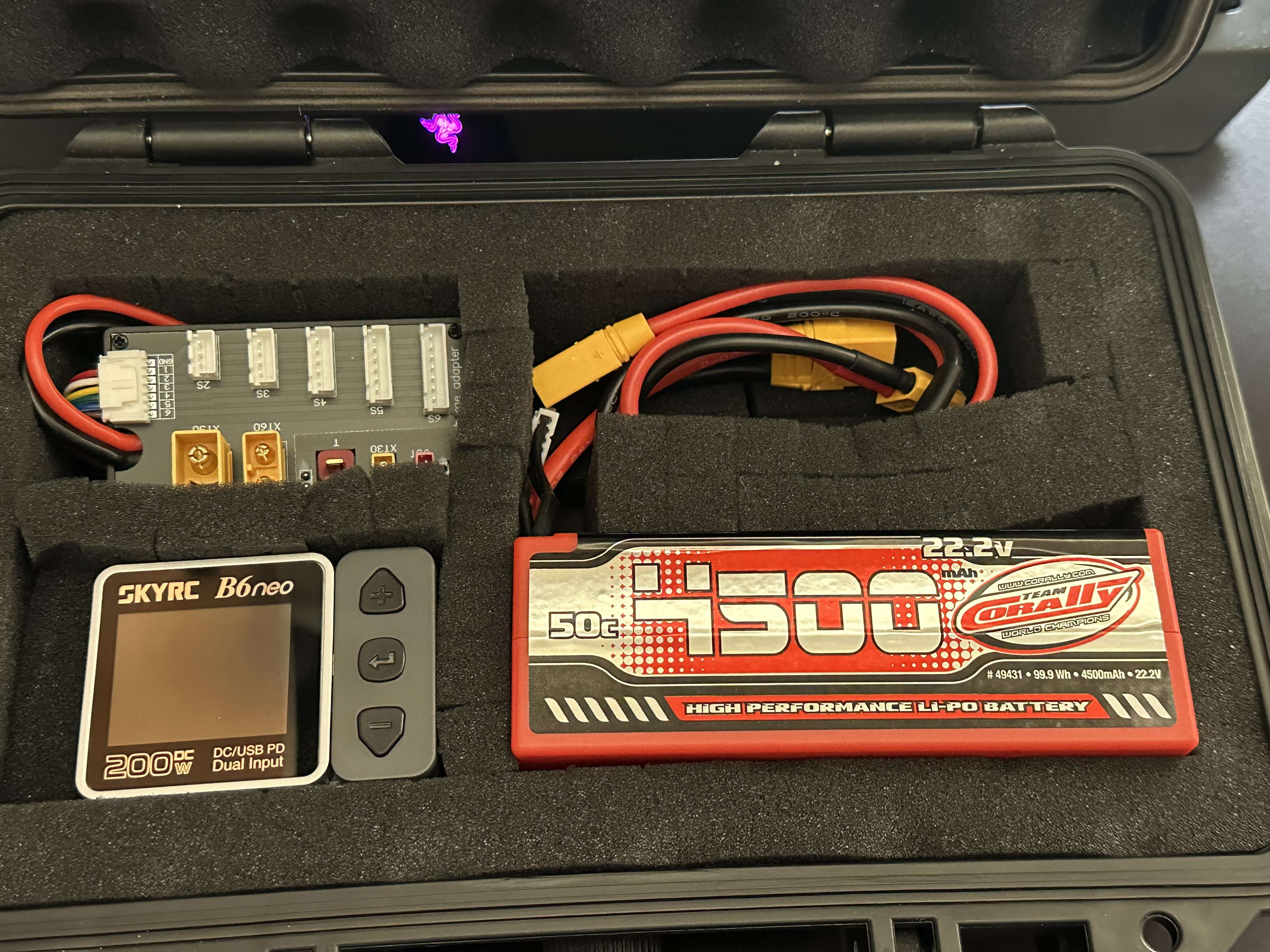

And to add to it you can also house them in a small peli type case to take them with you when you go bash..
