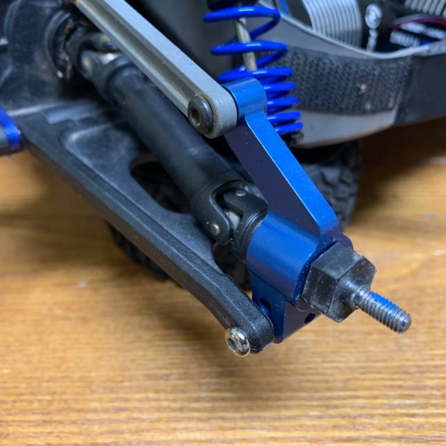

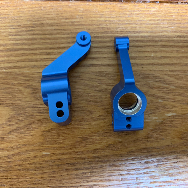

So it looks like I won’t be able to use the control arms. The RPM A Arms I received will not fit the Fiesta ST. Kind of bummed. RPM has it noted on their website. AMain does not. I guess I need to get arms for the Telluride and it doesn’t look like RPM makes them.
I did get the carriers installed and the car is back to running again. So that’s a plus.
So now I’m on the hunt for some A Arms for the telluride. Probably going to have to go with aluminum.

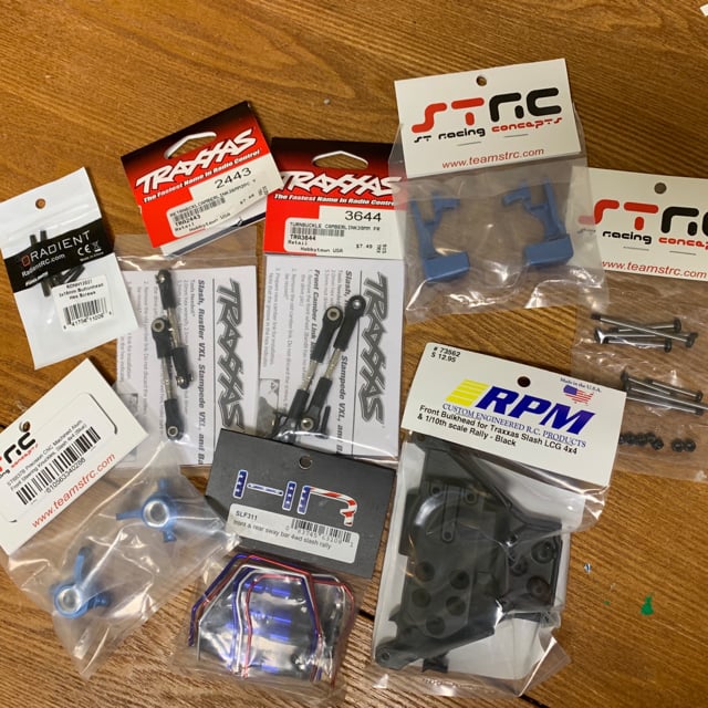

Tonight’s goodies to install

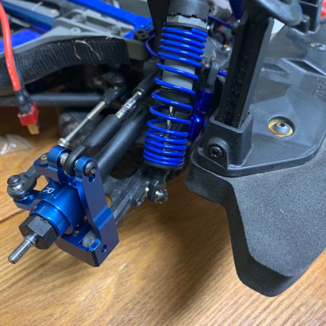

Not much to show other than the front knuckles and camber links. You can kind of see the sway bar.

Was finally able to properly test this thing out without breaking something. I wanna note that the Traxxas Slash and standard Rally control arms and camber links will NOT work on the Rally Fiesta. RPM doesn’t have an A arm kit for it either. If looking for an upgrade for the A arms search for the Telluride. The camber links and arms are direct swap. I went with Traxxas aluminum camber links 36mm and 39mm for front and rear. You will need longer bolts over factory.
Very happy with the way it has turned out. 3S almost seems to be too much for the car but it is too much fun. A little dialing in of the suspension and it should be good to go. Still going to do the GTR shocks upgrade but for right now these are doing great. Plus I want to figure out spring options for those. Just need to watch the spend and throttle when turning.
