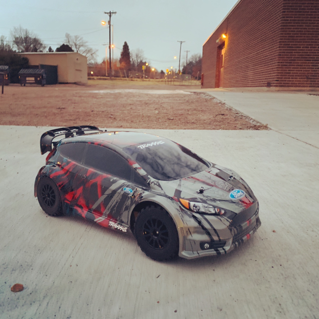

Decided I needed something a little faster in the dirt than a crawler, so I picked up a Traxxas Fiesta Rally. Took it out for a bit after replacing the Traxxas plug with a deans. Here is a picture of it before it even hit the dirt.

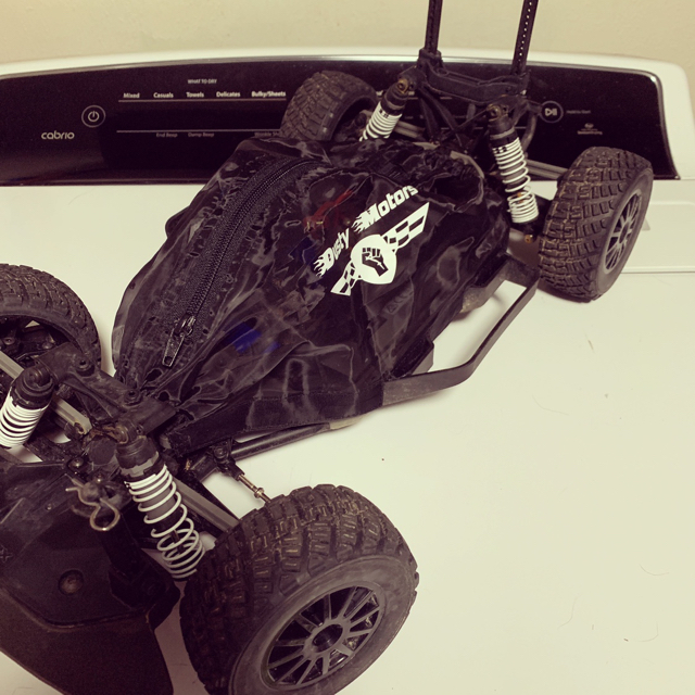

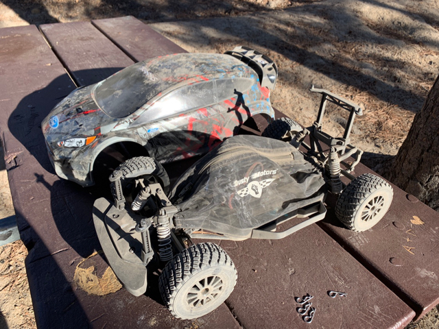

Installed the Dusty Motors shroud today. Hopefully this helps keep all the rocks out and from destroying things. Pretty easy to install and seems to have a nice tight fit around the chassis. Very lightweight and breathable. Easy to reach in to connect batteries and should be easy enough to remove for tear downs. Also came with synthetic socks for help protect the shocks. Not sure if I’m going to use those.
Took the boys out for a bit this morning to kick up and climb some rocks.
This shroud is amazing. Kept everything but a fine layer of dust out of the chassis. Didn’t even need to shake it out while running through a battery.

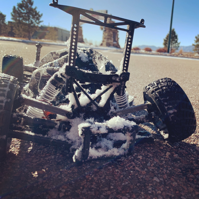

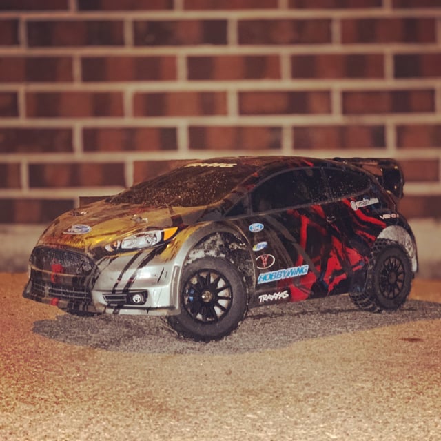

Haven’t been running the rally much. But we had a quick snow storm roll through and I couldn’t resist.

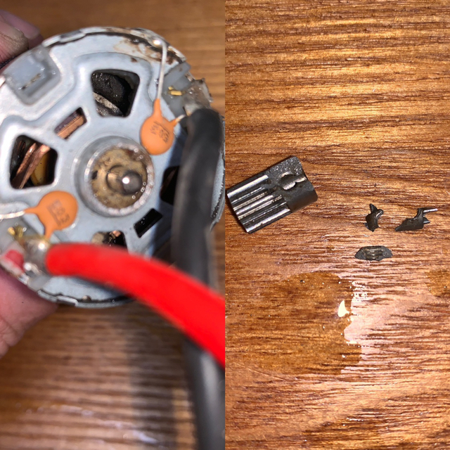

About a week ago I noticed that the car was taking a second to get going. Think of a slipping clutch on a real car. Didn’t want to engage right away just keep spinning up the motor. No big deal I figured I’d just upgrade to a differential anyway. Well that doesn’t seem to be the only problem. I toasted another motor along with the slipper clutch. So it looks like I’m going to go brushless.

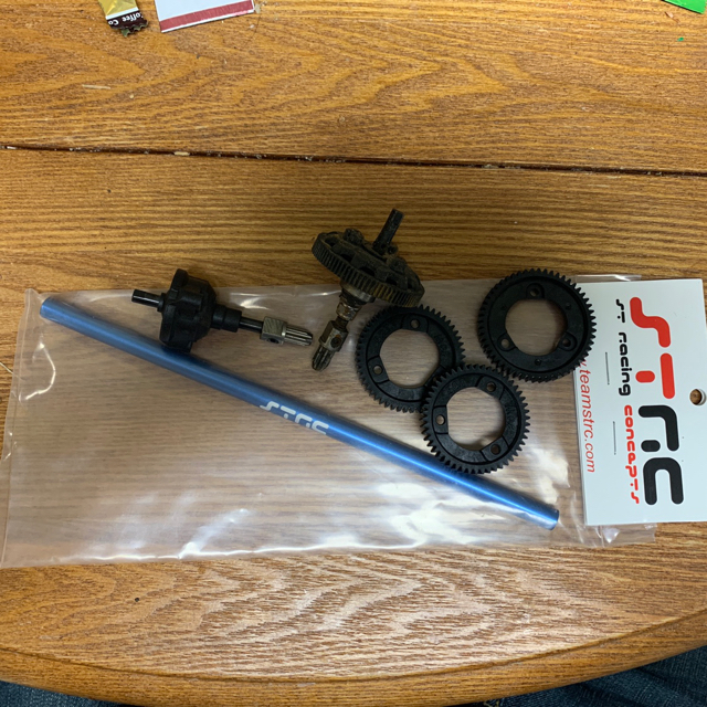

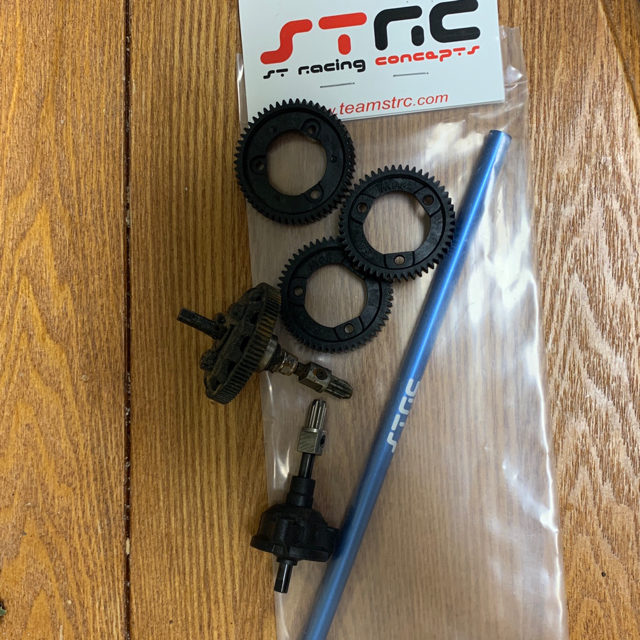

Couple questions regarding the differential though. I picked up the Traxxas center diff kit tra6814(see pic below) the spur gears in the kit don’t match the pitch of the pinion. They seem to be too “fat” for the pinion teeth to grab fully and they skip. This is with maxing out the pitch of the motor to meet the largest spur gear from the kit. (The other gears don’t even come close) has anyone done this upgrade? Is the answer to get a larger pinion? What one should I look for?
I also purchased a ST Racing center driveshaft to install but I forgot to order the front hub to go with it. My bad.
I think I have it figured out. I needed to get a 38p pinion. The one I have on the titan is a 48p. Lesson learned I hope. If I’m way off here please chime in.

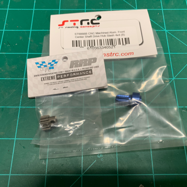

ST Racing Aluminum Center Driveshaft Hub
38p 12t pinion. (I’m going to order others as well.)

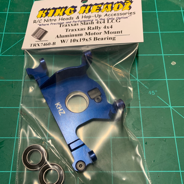

King Headz motor mount

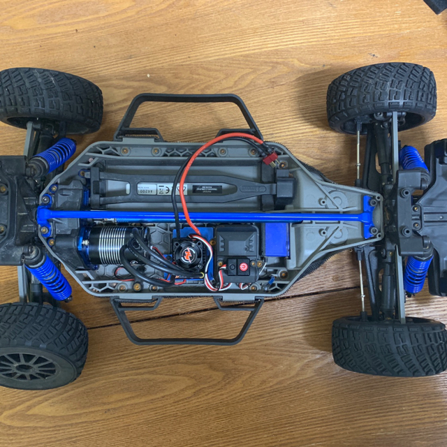

Waiting on a bunch of parts to get here, but the VG Racing Chassis Brace came in so I got that installed. Also I drilled out the stripped screw in the factory motor plate so I could attach the motor.

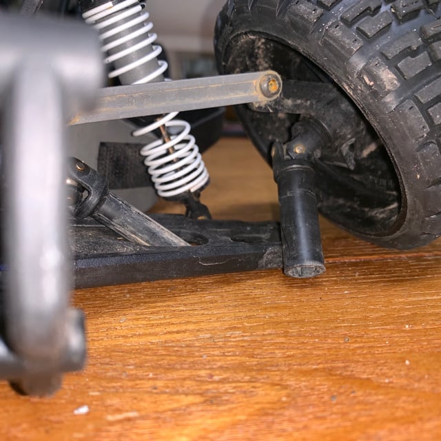

Damage assessment.
The damage looks a lot worse than it appears. I only broke the carrier and gave the wheel some curb rash. So nothing major. Ordered a set of aluminum carriers for replacements.

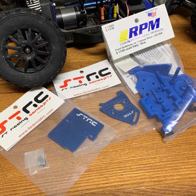

Some parts arrived today. The esc mounting plate, heat sink, and bulkhead. Changed my mind on the blue bulkhead though. I can’t seem to find a rear one to match so I ended up ordering a black one.

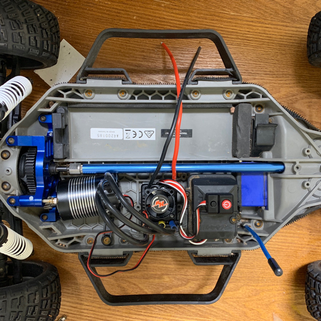

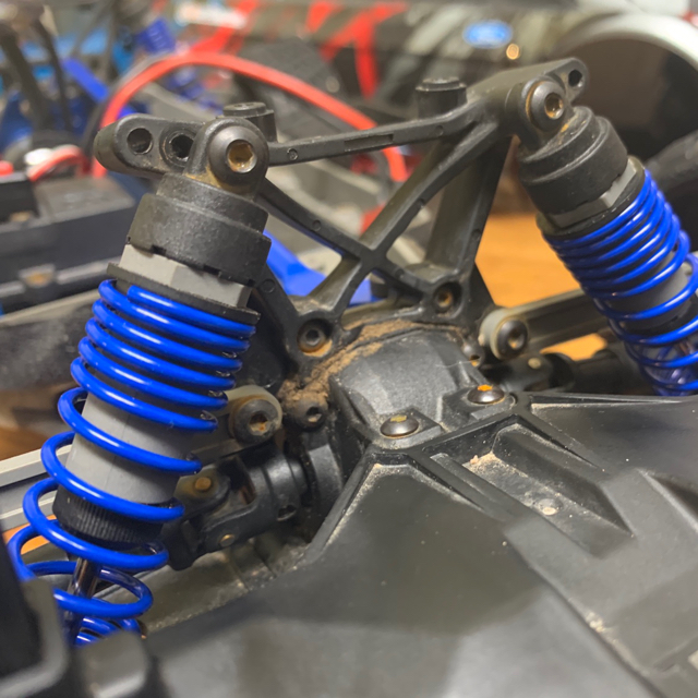

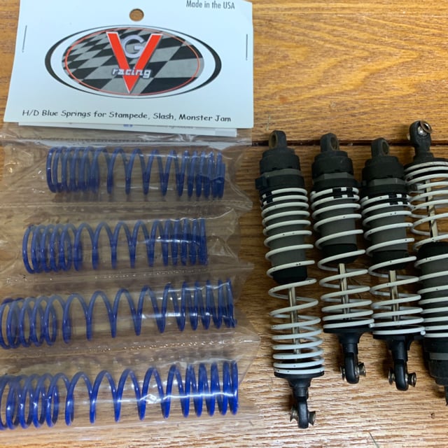

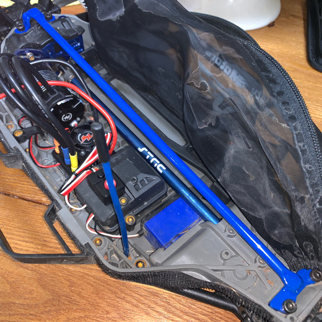

I was bored so I started installing the parts I have. Figured I might as well knock out the parts for the inner chassis.

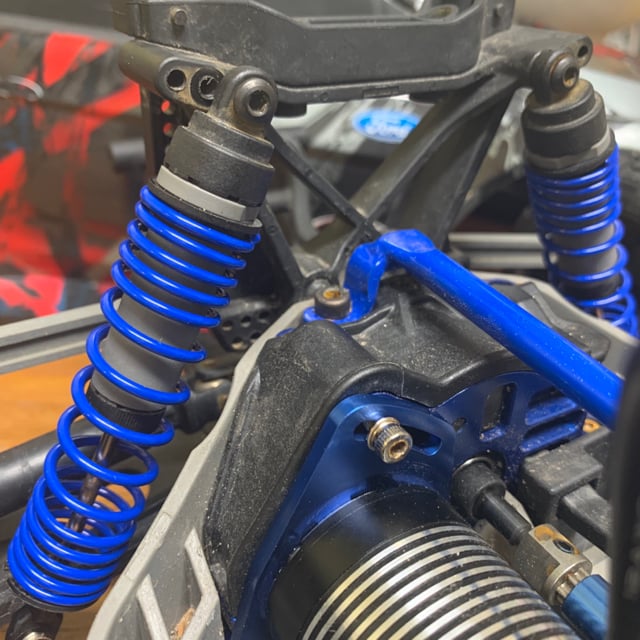

I started with the VG Racing Springs. These are much longer than I anticipated. These are supposed to be a +1 over the stock springs.
I decided them to the inner holes on the strut towers and the outer holes on the A arms to compensate for the length increase and give them a bit more of angle to hopefully help with keeping it rubber side down.

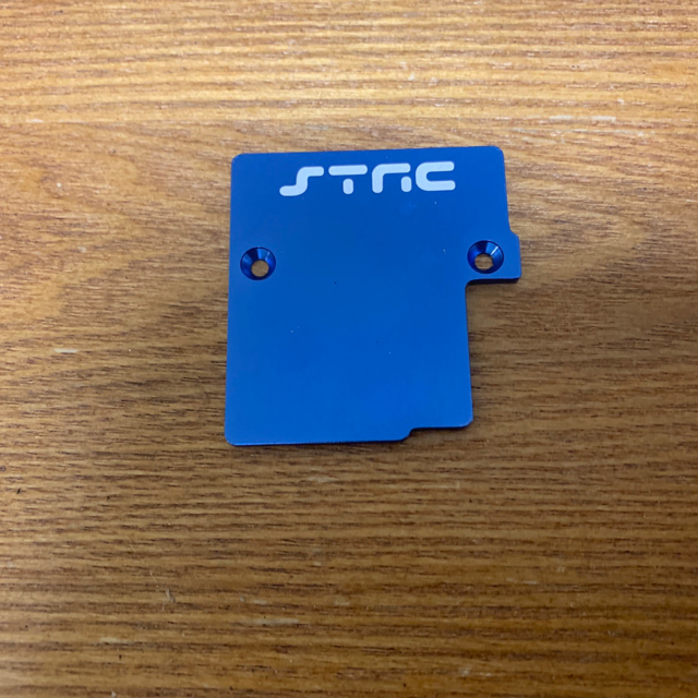

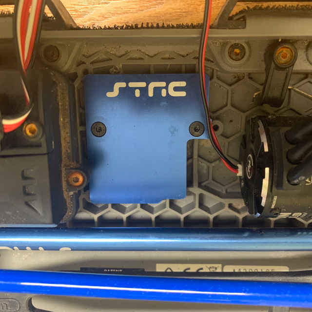

Next was the ST Racing Concepts ESC Mounting Plate.
The factory ESC just screwed into the chassis. Well the Hobbywing ESC uses 3m adhesive. While the Hobbywing did fit between the mounts that the factory ESC would screw into I still had to Dremel out the honeycomb to get it to firmly stick to the chassis. Figuring I’d probably upgrade the esc again at some point I searched (see stumbled upon) and found the STRC plate. Figured that getting the ESC off the bed of the chassis and using some outdoor 3m tape was a better approach. Plus giving the ESC a bit more breathing room to keep cool is never a bad thing right.

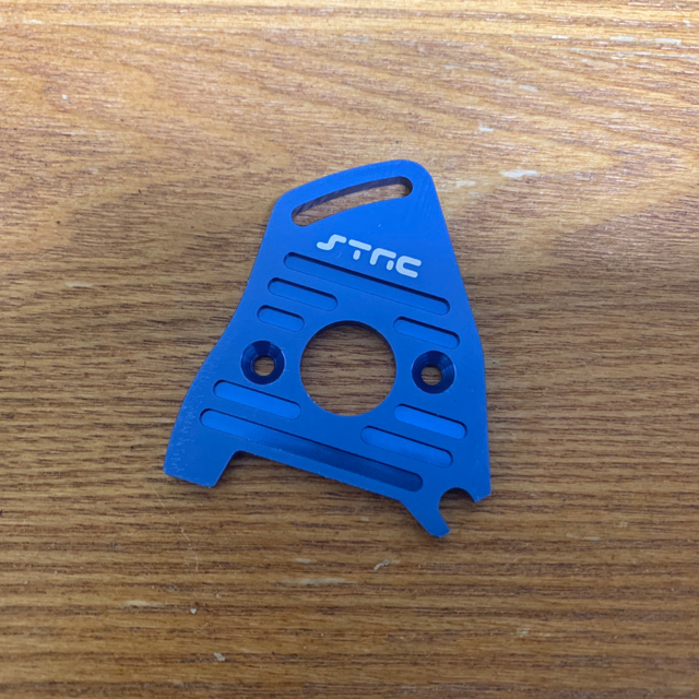

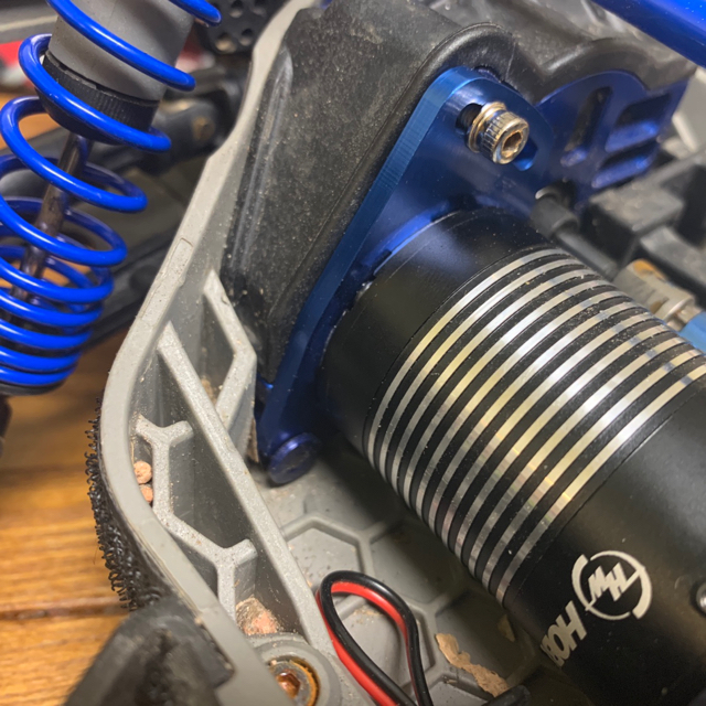

Next up was the heatsink.
Again,anything to help keep the car cooled off right? The stock one probably would have been fine but when I was installing the brushless setup I stripped the head off of one of the screws that mounts the motor to the heatsink. Figured I’d order another one before attempting to drill out the screw in the factory. (This is how I stumbled upon the ESC mounting plate) I was successful at drilling out the screw in the old plate but figured I’d throw this in anyway. Honestly if you didn’t know it was the stock one you wouldn’t even be able to tell.
Here is how it is sitting with everything I have received as of now.
