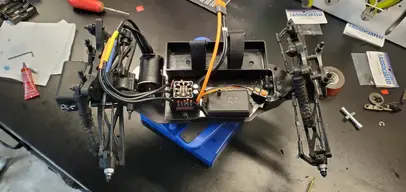

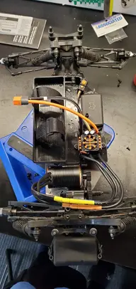

Yup, took a nitro firestorm 10t and made it like an e firestorm.. I bought a motor mount then modified it to fit the old nitro motor mount holes so I can move it to adjust for gear size.
