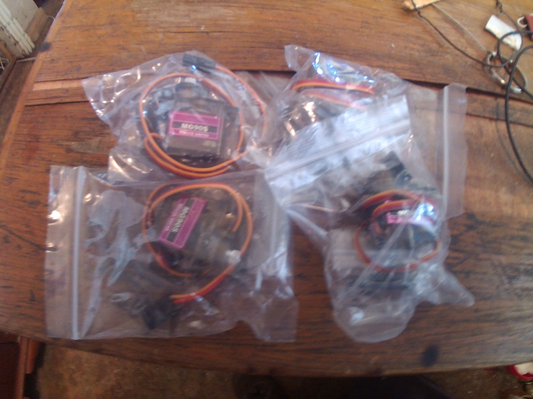

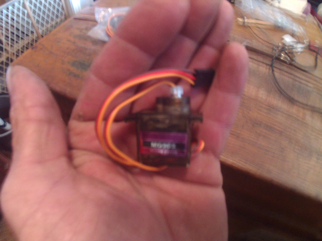

I bought these for me & G-son ,I also thought about updrades ,so your not the only one ,I think that someone here
had posted that truck on here before ,It made me take a second look at it ,it is pretty detailed!
Here is what I got ,they work well ,but the battery life isn't fun ,but they are cool!
