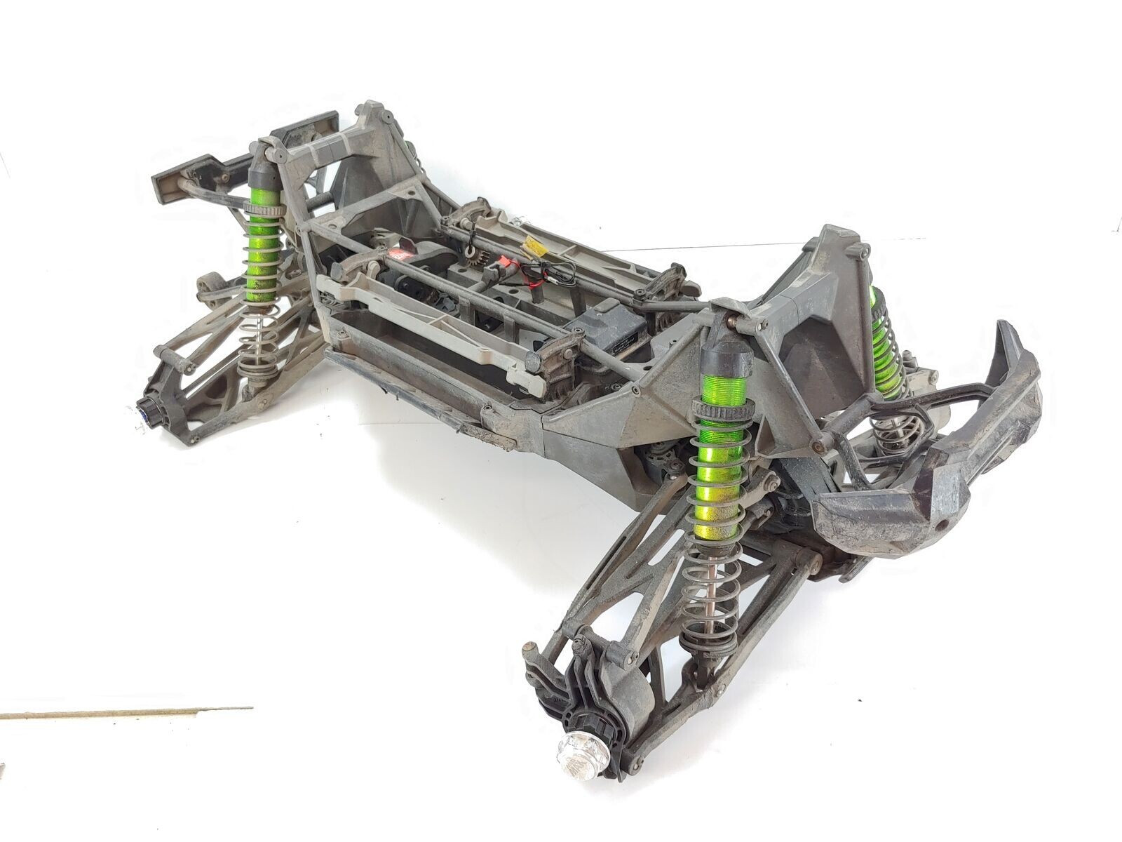

If i was you
i would start something decent easy
Buy a slider.
Choose righ parts, try keep it very light weight.
https://www.ebay.com/itm/275419481649?hash=item402047c631:g:h3YAAOSwseFi9SN7
Lightly used X-MAXX
without electronics, body, wheels and so on.
These are called SLIDERS.
You need buy self electronics, body, wheels, and couple smal things
This is a very good beginning
light weight also.
If you choose light weight wheels, and others tuff, this could be a Beast.
Also pretty cheap total.
You can buy from JENNYS RC
Arrma kraton 8s combo to this
160a 8s ESC, and 1250kv 8s 49 size spektrum motor.
Run it with two 6200mah 4s lipos.
it Would be a beast
these are very cheap from Jennys, the electronics

That X-Maxx slider... you can buy all that stuff brand new off Jenny's for just a tad more than that.
